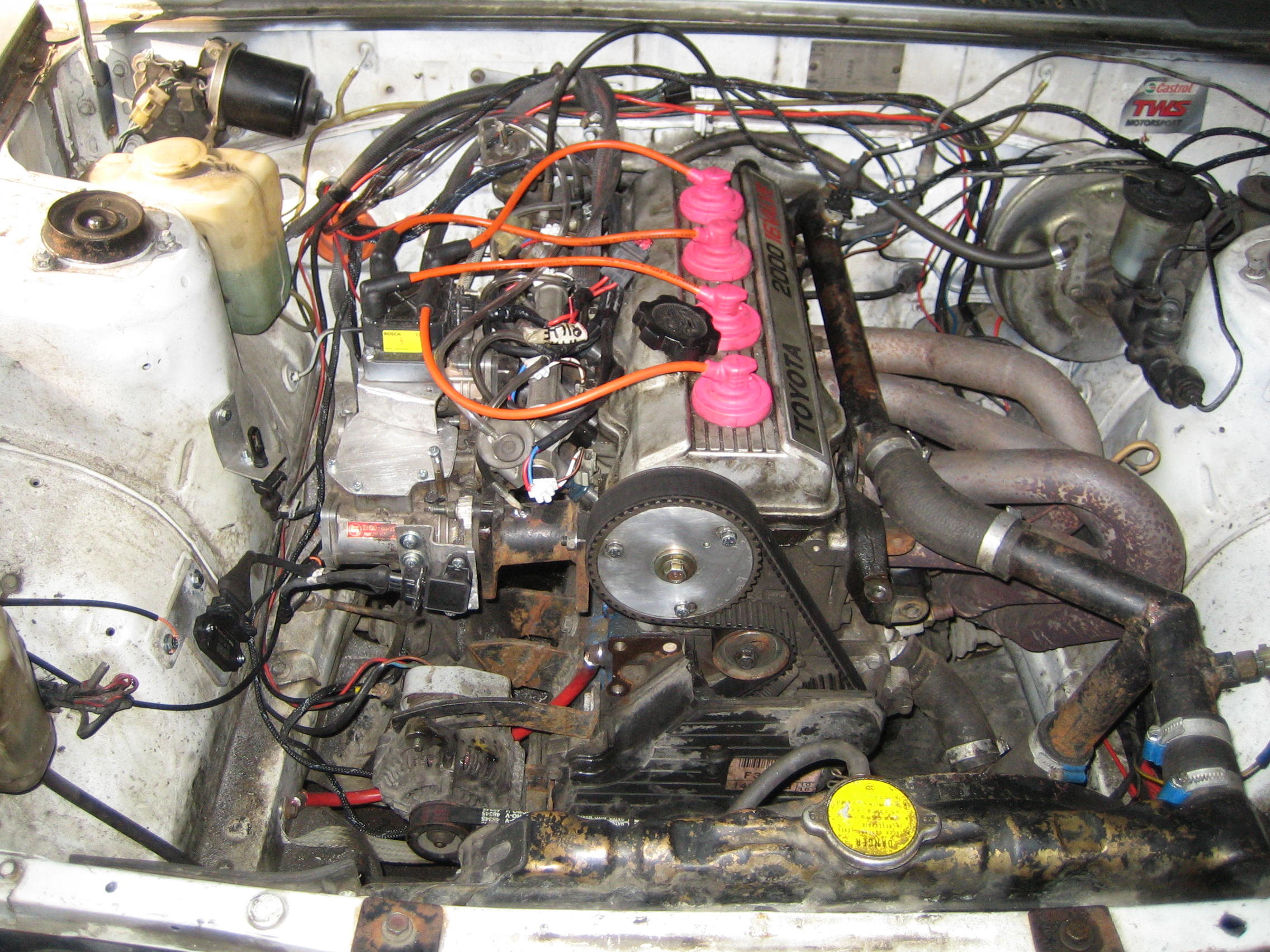

Yup. Turborolla put one in his rolla:
http://www.aeu86.org/viewtopic.php?t=1198
I thought he used a Supra gearbox and it was not a streight fit. Tongue
