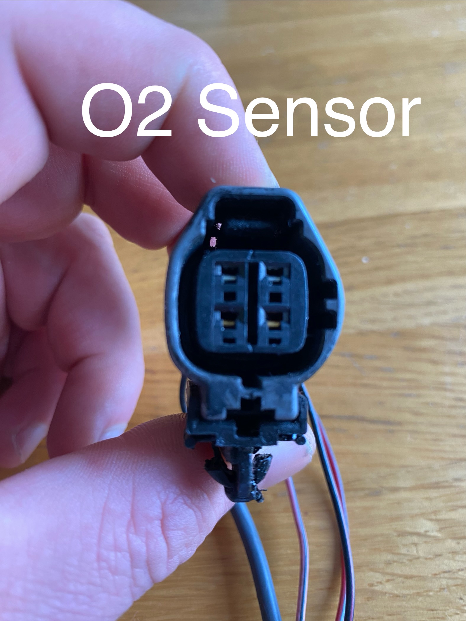

Hello guys, just wondering if anyone can help me out with the O2 sensor wiring for the Haltech.... I have chopped the sensor wiring off (ECU connection) which has 4 wires photos attached.
I have the Blacktop narrow band sensor, the Haltech wiring only suggests 3 wires to be connected is there something I don't need connecting ?
Thanks
