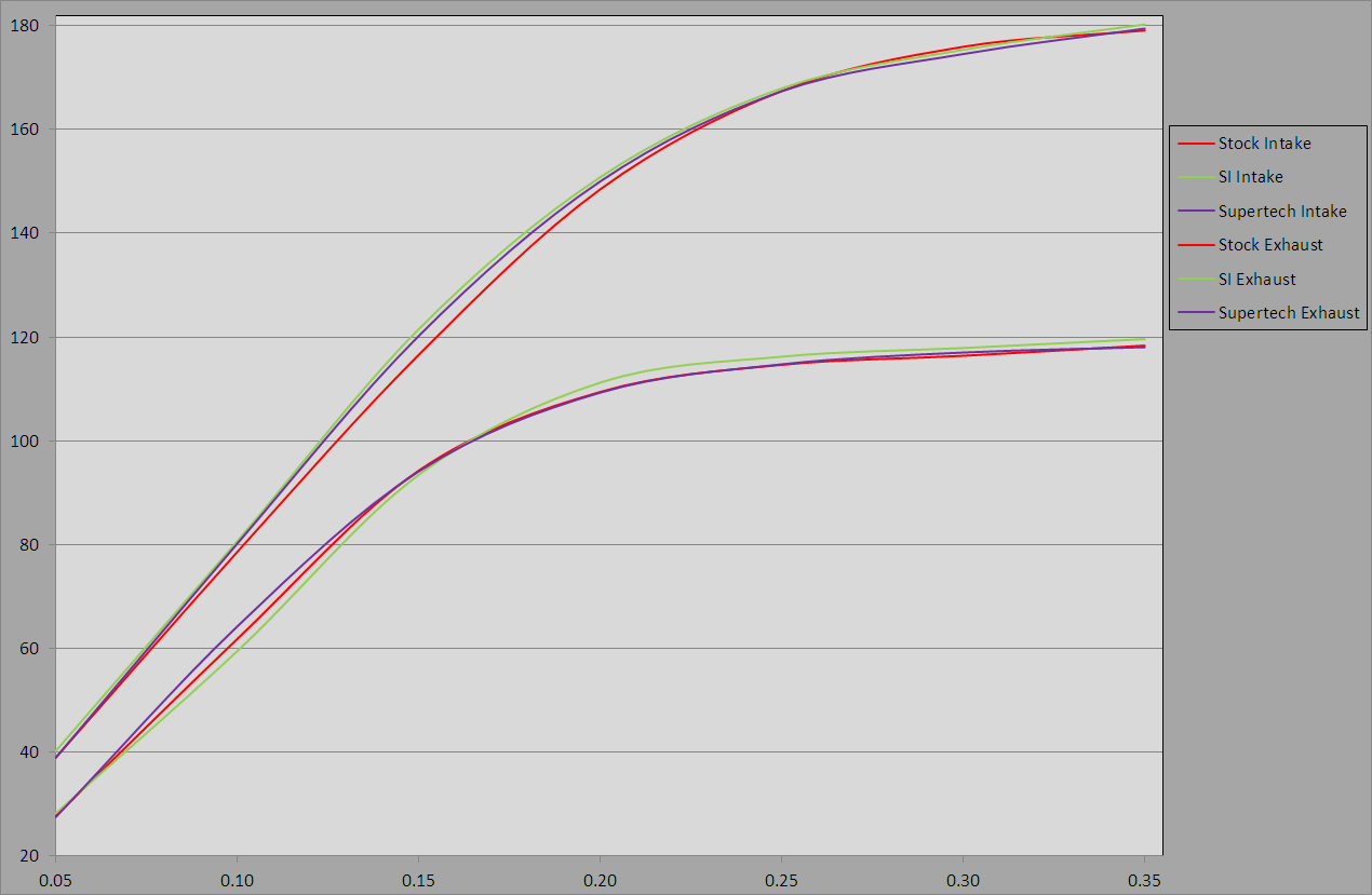

A bit of understanding of how the FP2 flowbench I have, operates... It takes air samples every 2 seconds, these samples measure air in CFM (cubic feet per minute) The samples come out to the tenth, I take 18 to 20 samples per setting, from those 18 to 20 sample 6 are randomly taken to then average. This is how I get to post readings to the hundredth. For TRUE actuality readings, look @ the number and figure the high number was .5 higher, while the low number was .5 below. For example in the first readings below ".050" - 27.78 - - 38.96" 27.78 was actually 18 readings that ranged from 27.2 to 28.3.
Some numbers.........
Stock chamber w/stock ports, stock valves no back cut
..........Lift - Exhaust- -Intake
  • .050" - 27.78 - - 38.96
  • .100" - 61.81 - - 78.58
  • .150" - 94.28 - - 116.58
  • .200" - 109.44 - - 148.48
  • .250" - 114.66 - - 167.41
  • .300" - 116.40 - - 175.94
  • .350" - 118.36 - - 179.08
Stock Chamber w/stock ports, SI valves
  • .050" - 28.22 - - 40.24
  • .100" - 59.47 - - 80.65
  • .150" - 93.47 - - 121.53
  • .200" - 111.23 - - 150.81
  • .250" - 116.23 - - 167.92
  • .300" - 117.90 - - 175.35
  • .350" - 119.62 - - 180.24
More to come........ Hurray!

10-02-2015, 11:44 PM
16V Valves....
oldeskewltoy Wrote:Some numbers.........
More to come........ Big Grin
adding.....
Stock Chamber w/stock ports Supertech valves
  • .050" - 27.50 - - 38.93
  • .100" - 64.23 - - 80.18
  • .150" - 94.12 - - 120.22
  • .200" - 109.31 - - 150.00
  • .250" - 114.77 - - 167.36
  • .300" - 117.03 - - 174.54
  • .350" - 118.05 - - 179.44
Ported results still to come....... Hurray!
Dan -
10-03-2015, 08:34 AM (This post was last modified: 10-03-2015 08:35 AM by Project D.)
16V Valves....
Funny how the SI exhaust valve flow @ low lift
10-03-2015, 01:35 PM
16V Valves....
"Funny how the SI exhaust valve flow @ low lift"
[Yes| There is a slight drip but I would think the overlap area [.050" low lift] would still be excellent.
The SI intake valve is a clear winner on that side. It will be interesting to see what porting and deshrouding will do for the numbers.
Great info for establishing baselines.
Dave W

10-04-2015, 05:46 PM
16V Valves....
As to the importanace of flow @ .050... look where the piston is @ .050" of cam lift?? Then look where the intake cam and piston are from 20 degrees after top dead center to 20 degrees after bottom dead center......
I'm not saying the numbers @ .050" are not important, just less so than from 20 after to 20 after....
Bean Bandit Wrote:Hope the Supertech fair a bit better on the ported head, else I've bought the wrong valves...
seems to matter.... but as to how much?????
Ported head
Ported head w/ stock valves WITH back cut
  • .050" - 27.53 - - 36.92
  • .100" - 59.83 - - 77.63
  • .150" - 92.16 - - 118.17
  • .200" - 115.31 - - 152.52
  • .250" - 124.52 - - 178.75
  • .300" - 128.77 - - 195.78
  • .350" - 131.11 - - 202.29
Ported head w/SI Valves
  • .050" - 27.12 - - 37.42
  • .100" - 57.10 - - 77.57
  • .150" - 97.28 - - 116.61
  • .200" - 116.28 - - 150.43
  • .250" - 125.32 - - 176.62
  • .300" - 128.87 - - 194.51
  • .350" - 130.55 - - 202.30
Ported head w Supetech Valves
  • .050" - 28.35 - - 38.83
  • .100" - 61.40 - - 78.72
  • .150" - 91.94 - - 118.15
  • .200" - 112.64 - - 151.93
  • .250" - 122.72 - - 178.27
  • .300" - 127.77 - - 195.50
  • .350" - 130.33 - - 203.43
Dan -
10-05-2015, 01:48 PM (This post was last modified: 10-05-2015 01:51 PM by Rascal21.)
16V Valves....
Interesting read! Thanks for putting your spare time into this Smile
So the conclusion, speaking bang for buck, unless chasing for 100% perfection, SI/ST/Stock valves (with or without back cut) on ported or stock (more or less) head does not really matter a huge lot?
I mean, if it stood between affording head porting or postponing everything for a set of ST/SI valves in addition?
It would explain why a lot of aftermarket companies who are into retainers, springs and underbucket shim conversions does not offer valves.
1x AE86 84` Zenki Coupè Levin 4A-GE 20v
1x AE86 83' Zenki Coupe Levin 4A-GE 16v
1x TA60 82' Sedan 2T 8V
1x TA40 78` MK1 Zenk/Pre-Facelift Wagon 4A-GE 16v
10-10-2015, 02:52 AM
16V Valves....
So realistically there could be a whole 1-2 hp in choosing the right valves Wink
