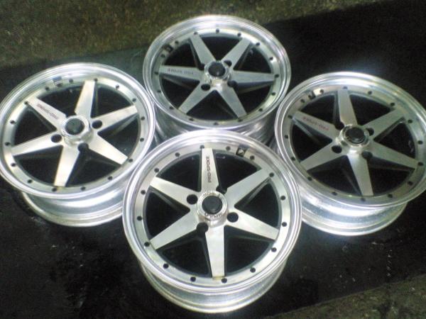

Hi everybody.
Recently I wanted to inprove my breaking performance. I almost decided to buy 3T break set. But it requires 15 inch wheels or bigger. I found nice set of 16 inch +5 Hoshino wheels. What do you think about the size? Is there any negative effect to the driving beside the more expensive tires? Do you have any experience with 16 inch ? peter Integra Type R vs AE86 Levin |

The offset looks wrong for ae86 but then I don't know the width. They look like something off an S13 or similar.You might need some big ass spacers.

If you look closely you will notice that the center of the wheel is quite deep. I think they will fit just fine You will have less comfort on 16... Sarcasme is just one of the things I offer Daily driver: '92 Toyota Carina E GTI Rebuilt project: '86 Levin hatch |

Jan Pedersen Wrote:hachirokuGTV Ah yes. I see that now. Your quite right! |

as he said the offset should be +5 then this mean it fit ae86.
