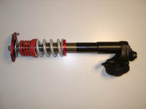

Contacted Intrax a few weeks ago for a question about coilovers for my dad's Camry. They where about 1300 euro. I couldn't resist to ask if they make coilovers for an AE86. If I'm not wrong the price is the same.
They are very nice and Intrax install them according to the wishes of the customer.
http://www.intraxracing.nl

You can get pretty decent coilovers for a lot less than 1300 euro's...that's more than twice what I paid for my car, or even 7 volvo's Big Grin

thats ALOOOOT of money Huh
