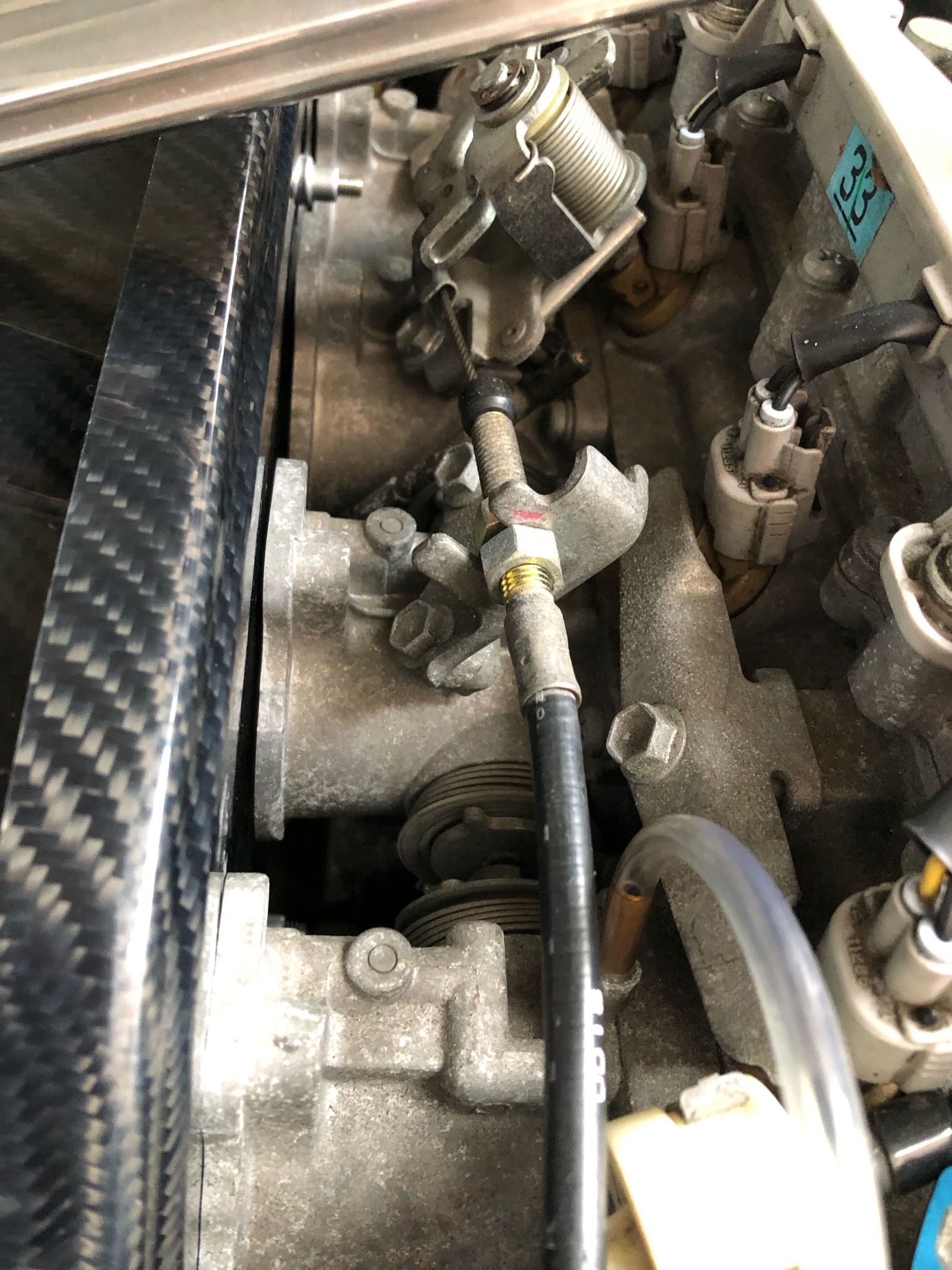

a small test fit has been done. seems like there is plenty of space in the back and on the sides so i am not worried about fitment anymore (ofcourse the box was designed on rhd cars so it makes sense that it fits nicely)
you can slide the box so far back the front itb falls off the baseplate a bit. i will be following the markings on the baseplate as i think they're pretty much spot on. i will have to trim the rear trumpet and maybe the front one too.
it also easy fits onder the cusco strut bar.
the baseplate of the box itself is a bit curved, carbon fiber is flexible so i'm sure this won't be a big issue but i will be making a nice thick gasket anyways for both the trumpet side and the itb side so it won't whistle.
furthermore i will probably add something on top of the screws that would enable me to loosen and fasten them by hand.

Is the base that far off? Or aren't your throttle bodies fully aligned to begin with?
[Image: AEU86 AE86 - the noby booth chronicles]
03-01-2024, 05:33 PM
(03-01-2024 05:09 PM)banpei Wrote:  Is the base that far off? Or aren't your throttle bodies fully aligned to begin with?
the base is that far off... it is convexed inwards. Like i said it'll probably be fine as cf is plenty flexible but all the more reason to run a good gasket i guess
it is very evident that this solution is anything but plug and play!
