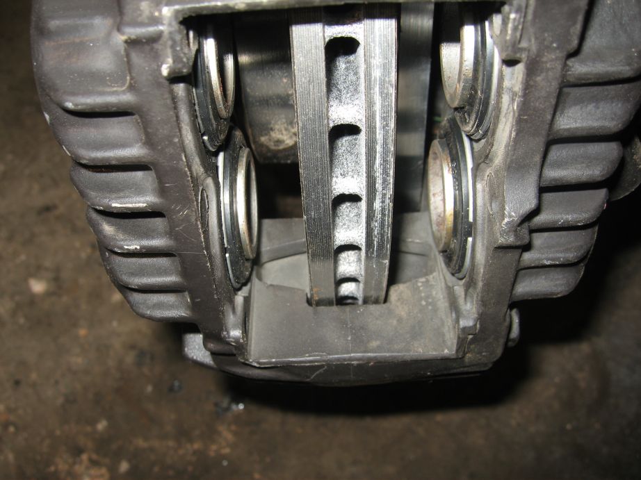

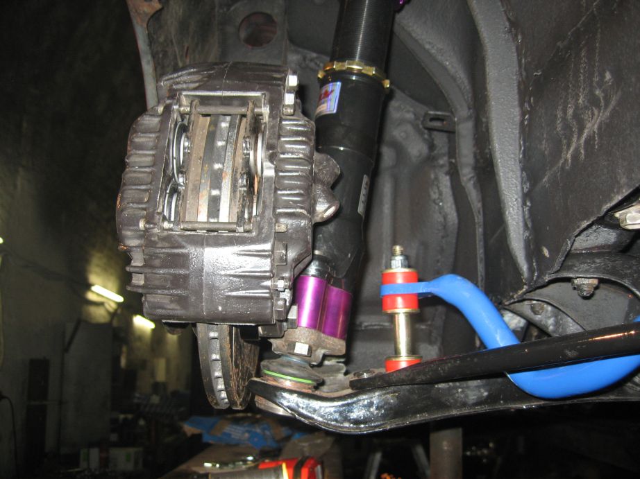

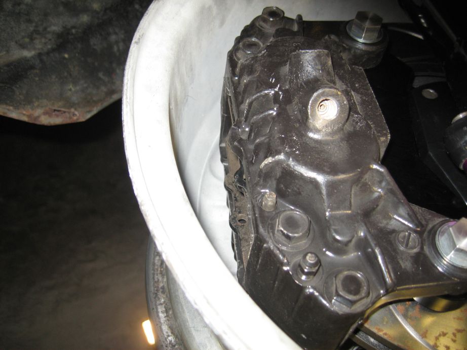

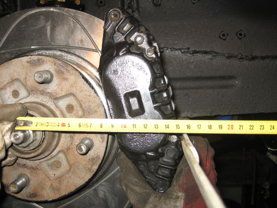

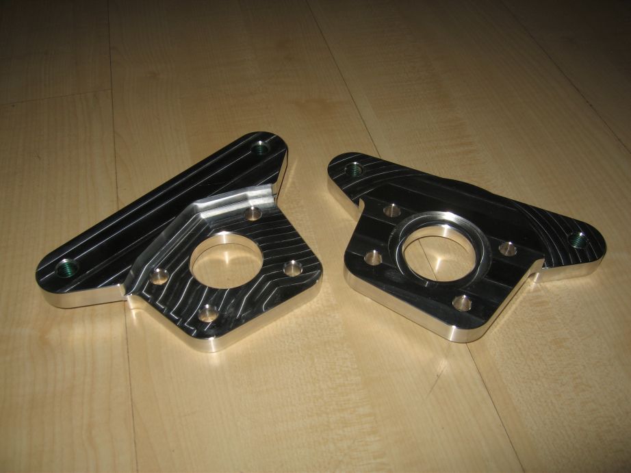

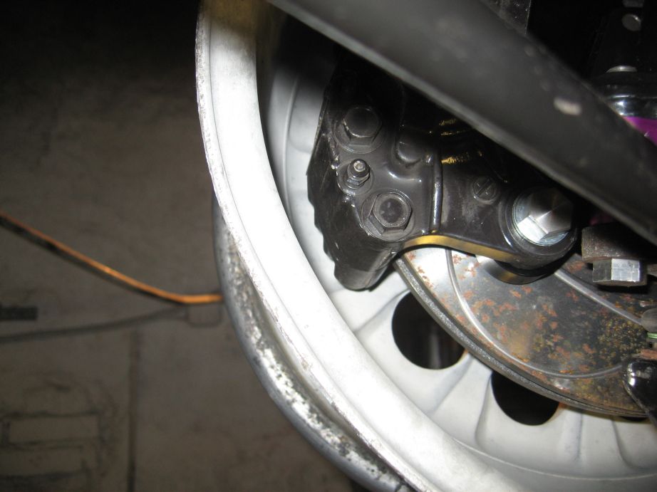

Hello everyone,
some of you may know that i have sold quite a few RX7 brake adapter brackets. As i no longer have the opportunity to make and sell them i thought i share all my R&D about the brackets.
they are designed to use with
· RX7 FC3S or FD Calipers
· Mini Cooper S discs - Ø276x22mm
a few pictures of the brackets
the 2 zip files contain the left and right bracket in various formats
*.par
*.STEP
*.SLDPRT
*.x_t
*.igs
Drawings in pdf and dxf
have fun Cool
