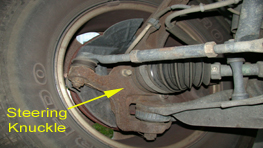

when u mean change the steering knuckle u mean change this like the picture and change the tie rod i can understand that but what u mean with good lock when u change the tie rod what kind ?shoter?larger?
really this is new for me
