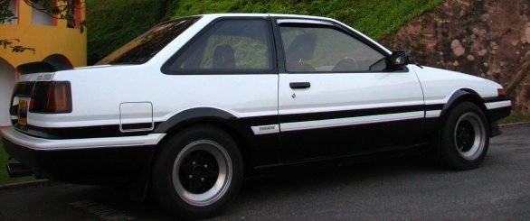

hi guys,
I'm Heshan from Sri Lanka and I'm a huge fan of the AE86 and I finally bought one. I need you guys to give me the exact details as this came with absolutely no documentation.
Its an AE86 but a bit of mods in Japan. The only pic i have for now is attached. It has sort of a cold air intake system (APEXI), a "thrust" exhaust, a nardi steering, GAB pressure adj shocks, etc.
Please tell me what you guys think of this baby.
also I've noticed the rev limiter is at around 7.8 - 7.9k. is this normal or do you think the japanese did some mods to the engine?
is there anyway i could identify a APEX by its looks rather than the 4AGE engine?
thanks in advance,
heshan. [/img]

I think that your engine is a map and not afm. So if its a map then its normal to have rev limit up to 7800
