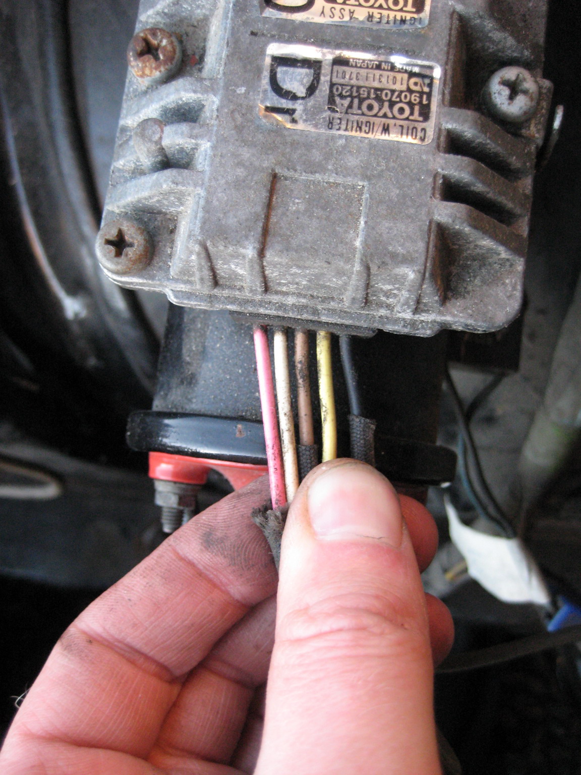

I am having som trouble figuring out which color wire is what for the igniter (MAP). Black and brown I know... but what about whit, pink and yellow?
- Thanks, Niels
