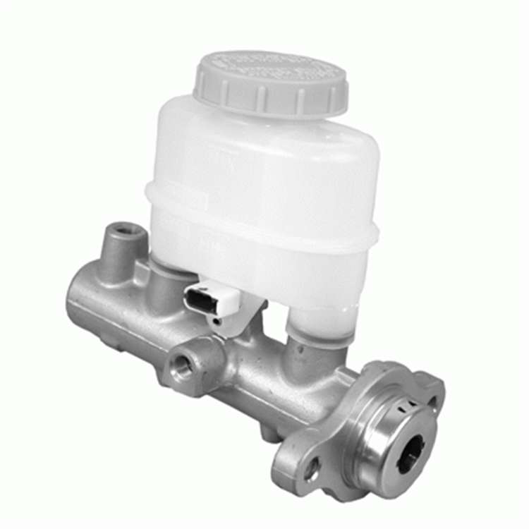

Finally bought this : Nissan Navara 15/16" , 2 bolts fixing.
It looks perfect for fitting . Rear hole is in same place , and the lateral(left) one need the hose to be a little bended . So it's easy to fit . For the upgrade feeling , you'll have to wait . As I already said , no engine for now . I'll left feedback later . Here's a little picture of the Nissan Navara (1999) BMC (also named King Cab) Filh Save the RWD cars |

how 'bout an MC from an 86 Nissan 200sx (gazelle). bore is 15/16". mounting holes LOOK to be the same. just have to confirm.
compare: AE86 MC: ![]() 200sx MC:

Done for me , with Nissan Navara bmc.Almost bolt-on . Only a hose to be bent a little (from up to side of Bmc )
The pedal feeling has totally changed . It's now very hard . I have a proportional valve . I've got no problem with rear brakes blocking. But it's very hard to get the front wheels blocked ..... Maybe a brake booster linking problem ? I'm rallying this week-end , hope I 'll have good news . Phil Filh Save the RWD cars |

Have you readjusted the link rod that pushes the master cylinder in after swapping master cylinders?
