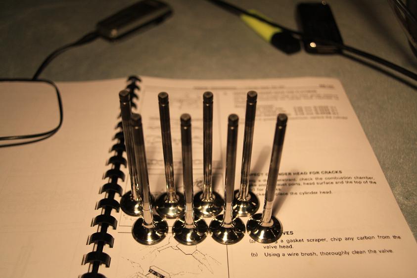

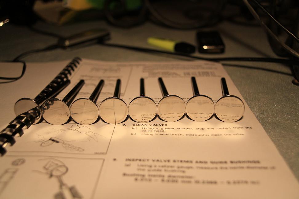

Finally the valves are polished.

Wicked! Cool
