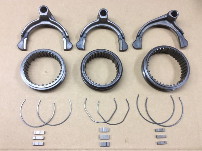

02-01-2020, 07:07 PM (This post was last modified: 02-01-2020 07:12 PM by Project D.)
gearbox overhauling
For the full rebuild kit, contact William: haxengineering [AT] gmail.com
The kit used to be $AUD480 (~€300) + Shipping in 2016 when I bought mine.
No idea how much he sell them for now or if he still have them...
[Image: AEU86 AE86 - gearbox overhauling]
For the forks and sleeves:
https://www.etsuryu.com/apps/webstore/pr...ow/8084222
¥40000 (~€340)
