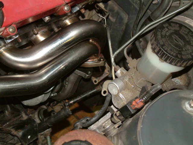

Aico Wrote:Also we have the steeringaxle on the exhaust side. So most RHD manifolds won't fit ours.
Steering column vs greddy exhaust manifold/turbo/downpipe - 1:0
Couldn't sleep 3 nights because of this problem.
Manifold is for RHD cars.
