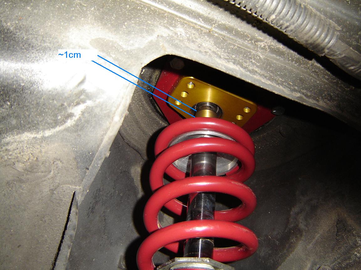

But when I want to install other coilovers I got a problem with
the height.
Do you have an advise what to do?
If I lower them the same as the old coilovers I have 1 cm play in the top.
See arrow in the picture.

The shocks under the trueno are to soft and not adjustable.
But if I install the T3 coilovers I have some space between
the spring and the camberplate (only if i lift the trueno).
So I think I have longer shocks in the T3 coilovers then the
tein set.
Is it a problem to have 1 cm space between the spring and
the top of the coilover?

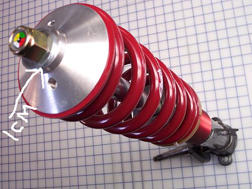

added another pic

@toypower: Check the length of the struthousings, maybe one is shorter. The cm difference is not a terribleproblem, but you will fail MOT..two possible solutions are: get a pair of longer springs with the same springrate or get a pair of helpersprings (available from whiteline for the ae86, but in reality almost any set will work.

@toypower...same springrate should be softer springrate..so better get the helpers..Do you have any pics of the old setup? Partnumbers etc?

The old setup has nice TEIN coilovers. But I think the shocks must be
replaced.
So I will take these apart and find some better shocks.
