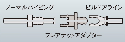

Yes it is. But I think it doesn't work because my car come from Japan. European car has Bubble flare and Japanese has inverted flare.
[Image: AEU86 AE86 - braided brake lines]
You can see the left part on the photo.
Now I need to find the adapter showed on the middle of the photo.

Or make a new end on your own brakeline? It's not that hard to make a new flare with the correct tool.
