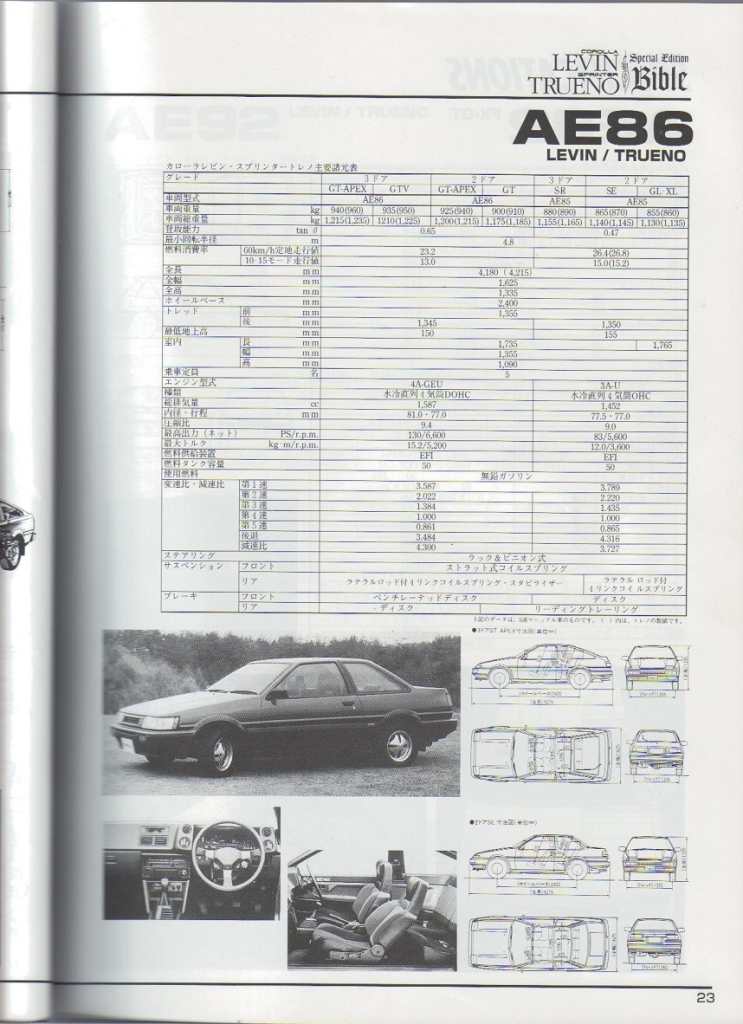

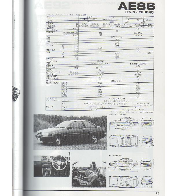

The answer is yes, but actually you're making it AE86 then since you're swapping 4AGE and T50. Wink
http://www.aeu86.org/index/engine-ae86-s...post=72098
