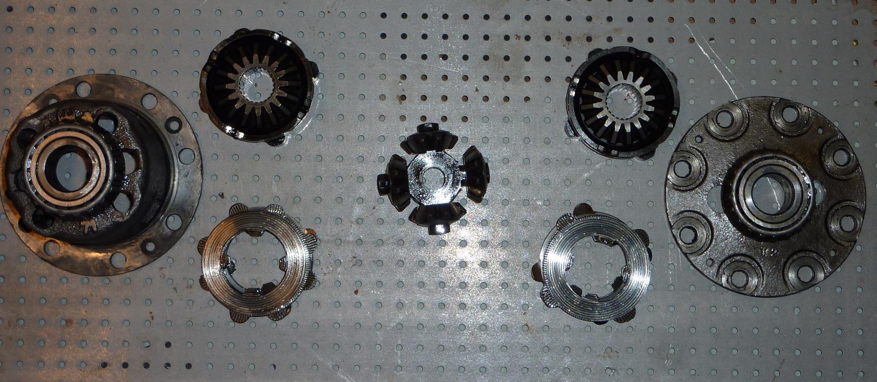

I need help to know the LSD Type shown on pics
I know it's a TRD
But what type : 1 way , 2 way .....?
Thanks for helping
Phil

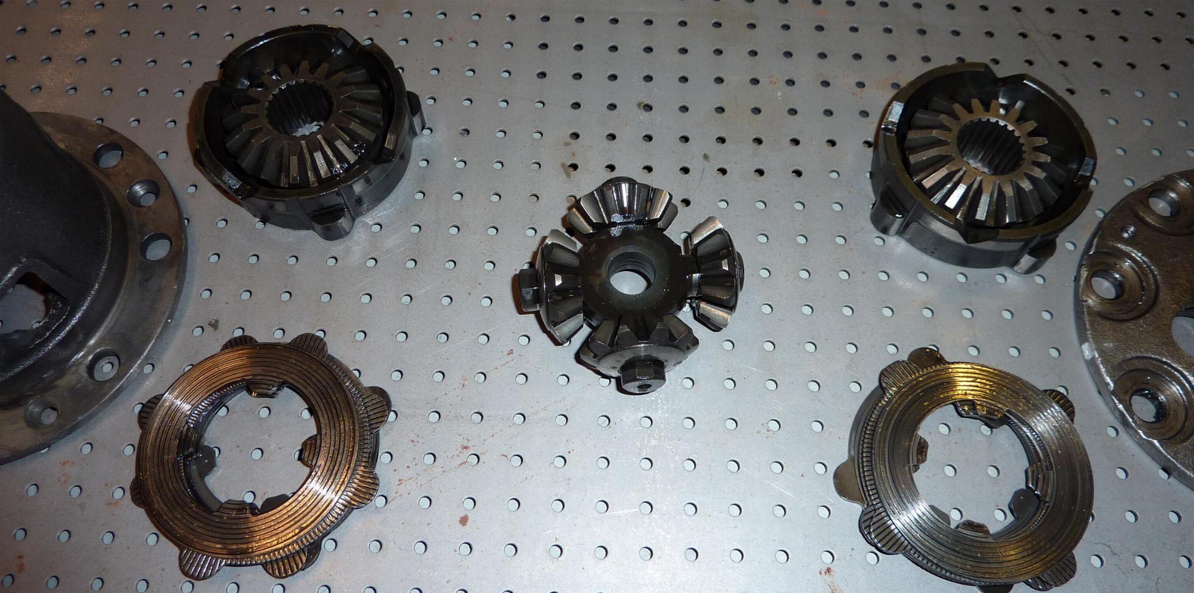

2 way for sure Wink
It is really late for me, so I will explain in French, sorry for people who don't understand french...
regarde sur ta 2nd photo, les 2 pièces en haut.
l'endroit ou se positionne les axes de satellites (les petit pignon) sont en V parfaitment symétrique donc 2 voies Wink
si c'était 1 voie tu n'aurai un demi V ( |/ au lieu de \/)
et un 1.5 voie tu aurai un V non symétrique (un coté plus prononcé que l'autre)

This is a two way..you can see the two diamond shape ramps (ramp angles) on both diff halves. They are exactly the same, hence two way. I guess projectD said something along the same lines. You can see them in the second pic. The two thingies at the top.

You're right, just checked:
Zenki 2way
41301-TA005
Zenki 1.5way
41301-TA006
Kouki 2way
41301-AE804
Kouki 1.5way
41301-AE805

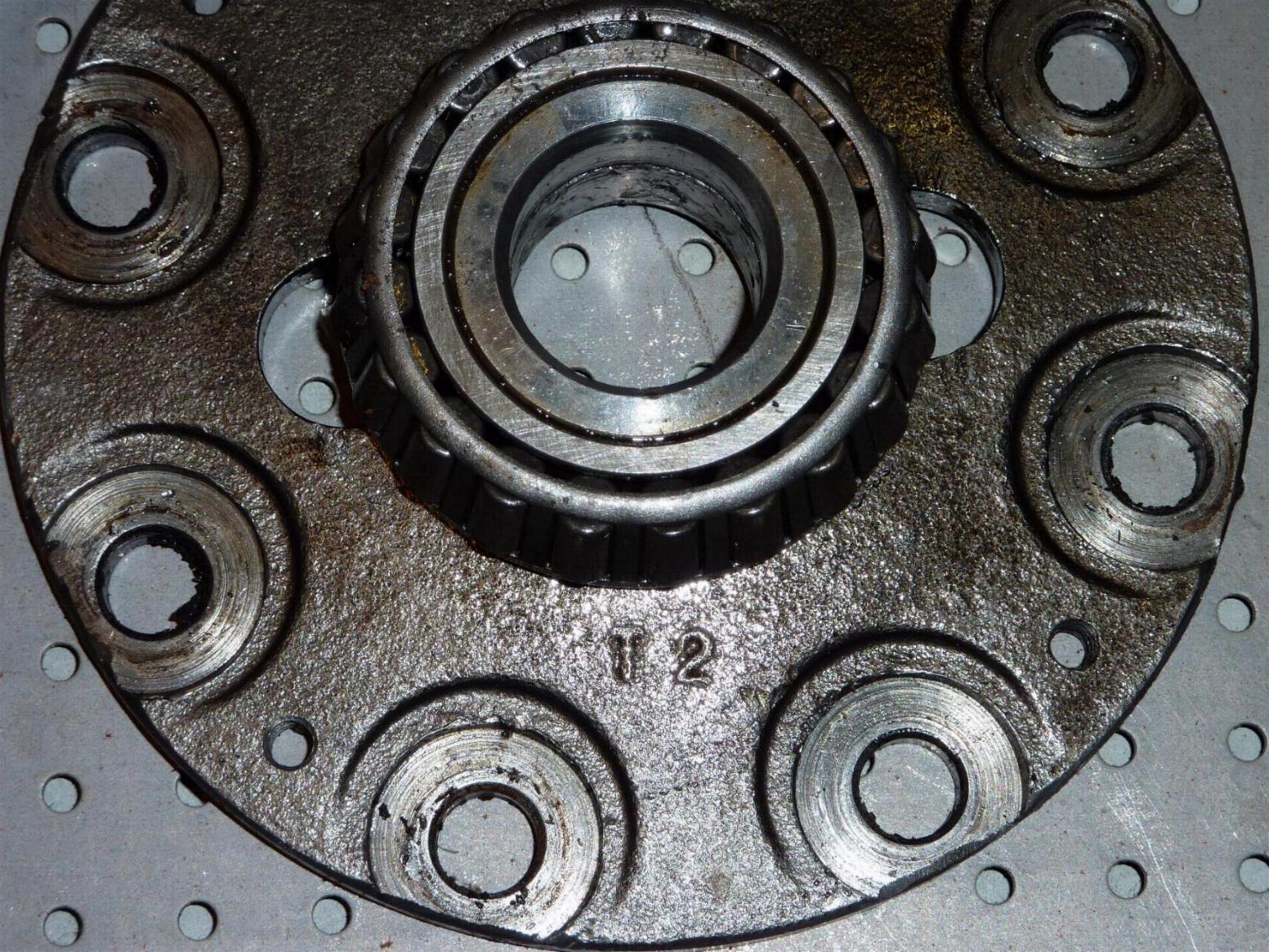

I also noticed a T2 mark on cover , guess it's the abreviation for Two way .
I think I know what I need to buy .

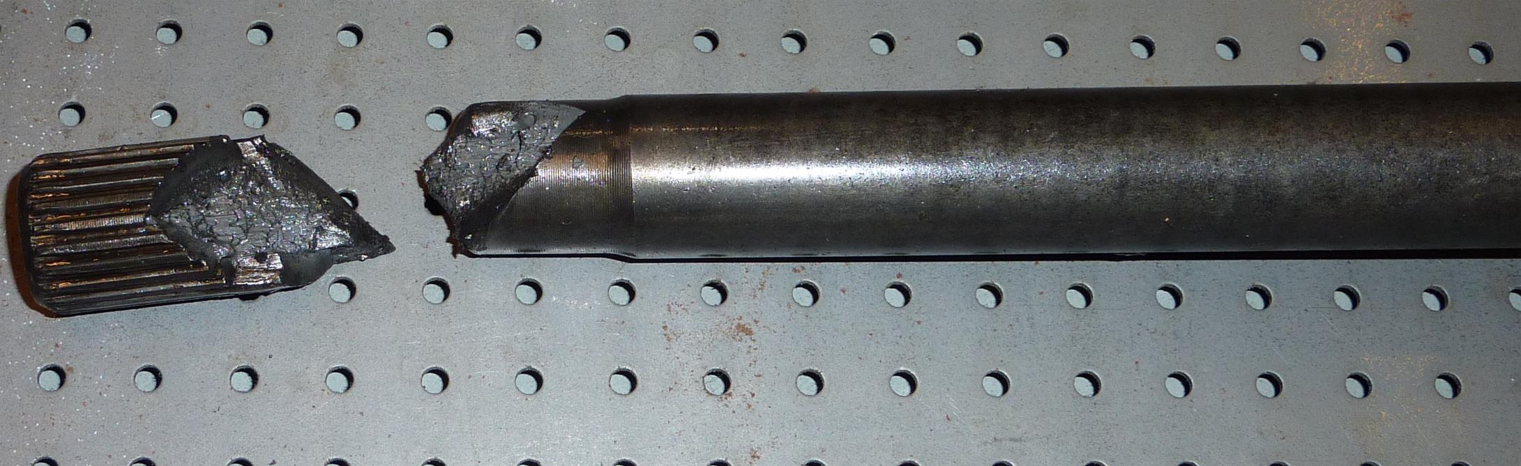

I broke a half shaft (it's the fifth one) due to rallye use ....
And when cleaning gear end I found that LSD is cracked on the just under cover plate .

Yes I saw the big half shaft , but I'm not sure it's the solution for me . Ionly have 135hp, but it's the way I drive in rally that lead to the half shaft explosion....
