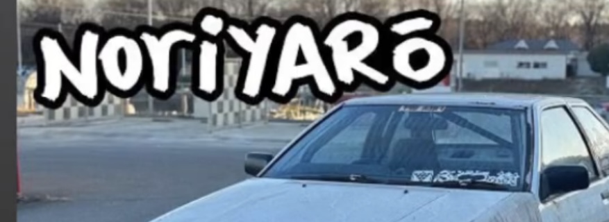

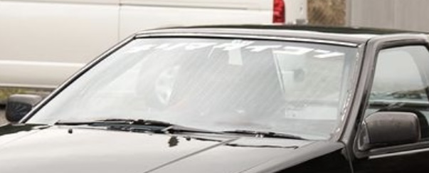

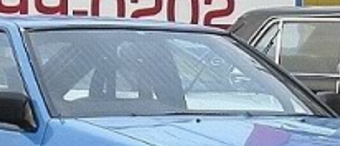

Mine has that also, more noticable when it’s raining. Just had a quick look through my phone and found more, even alexi bean86 has it.
