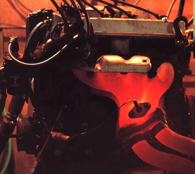

It can be on different places. But here you see where it is fitted for my
trueno.

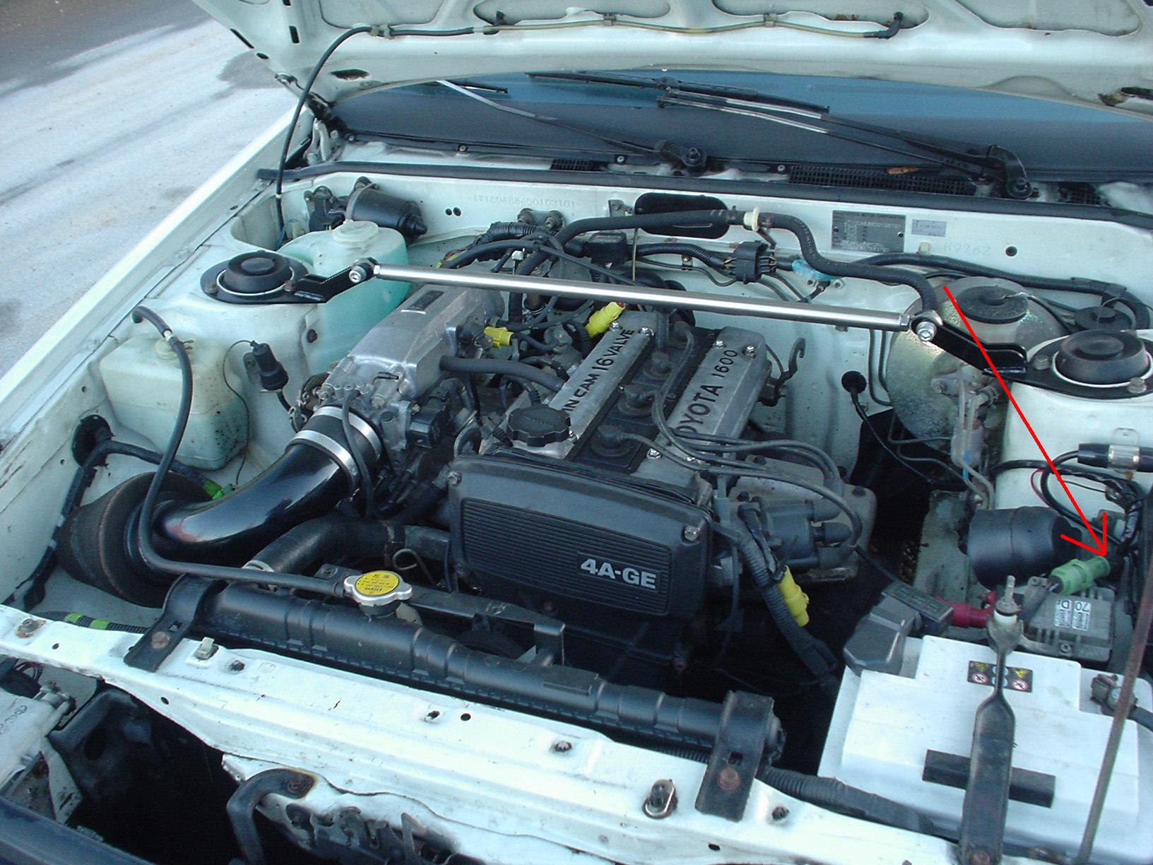

08-18-2006, 12:00 AM
Where is located lambda on ae86
Take a look at this part, located behind the battery. It controls the fuelmixture.
[Image: AEU86 AE86 - Where is located lambda on ae86]
