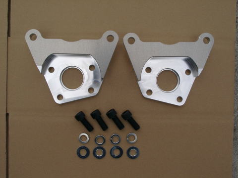

Pictures of the EG6 kit, 25,000 Yen
[Image: AEU86 AE86 - What brakes are you using ?]

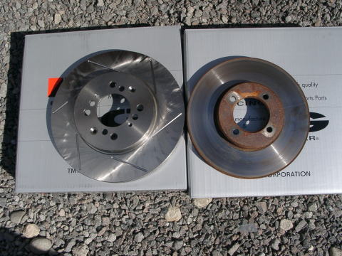

Do any of you know how wide a disc,that can be used with the OE caliper?
There are some c-class disc ,that are 285x22.and they are easy to redrill,becourse the MB holes are drilled on a 105mm pcd
And i wonder if it can fit the 22mm instead of the 18mm ,is there room for it?

AFAIK you could use AE92 front disc with stock AE86 caliper (238mm).
Measure the central hole of your c-class discs - if the hole is over ~65mm - they are not applicable (you must redrill them to 4X85 PCD and 12mm holes for studs will be very close to the central hole - that's why I fail using BMW 728i discs).

the hole in the c-class discs are 67mm.Yes it will be close ,but there are no force in that direction,so i don´t think it will be a problem
I wan´t to have the discs bigger for better cooling,that´s why i wount use the AE92 discs
