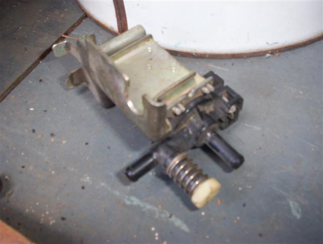

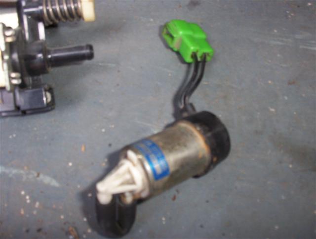

Sorry for not saying so before but my AE86 was a USDM GTS not a SR5.. The Japanese engine I got did not come with any of the VSV or A/C stuff. The ones I have pictures of are ones from my GTS that was removed when the GTS Engine was pulled.. The A/C Idle up ( Right side of the picture ) still has the plug in the engine bay. However the VSV ( Left on the picture ) has no place to plug into now? The plug for it went with the GTS engine harness.. Do I need to rewire something or still contact the person you mentioned above even though I am not using a Sr5?

The GTS charge loom should have these presumably. The VSV on the right is an aircon idle up and on JDM cars is mounted on the front of the right hand side (as you sit in the drivers seat) strut tower. The loom plug for this comes from the branch leading to the alternator.
The VSV on the right is a general idle up and on JDM cars has a loom plug situated low down in the right hand side of the engine bay near the standard airbox. In fact it actually mounts on the airbox in a JDM car

Picture 2 ? goes to the idle up solenoid you have asked about in picture 4 (with the green plug), specifically the end nipple, then the inner nipple line goes to the airbox on an AE86, or the I think to the intake tube on an AE82.

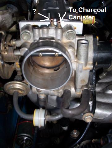

Picture 3: 4 & 5 are coolant feeds for the waxstat. 1 & 2 I think are for the power steering( block these off), 3 goes to the aircon idle up solenoid (picture 5, specifically the F [vacuum] outlet), the other outlet on this valve (e) goes to the airbox.
There is no point bothering with the two idle up valves in 4 & 5 unless you have the rest of a functioning idle up circuit. On an AE86 this is incorporated into the loom that includes the headlights and charge system from the fusebox in the engine bay around to the junction box in the drivers footwell, then across the car through various diodes within the dash loom to the ECU. Earlier 4AG AE86's then had an idle up computer (a black plastic box slightly larger than a ciggie packet) which clips on top of the ECU. I think later looms incorporated this within the ECU, and I think this was the case with AE82 twincams (?)
Having a functioning idle up circuit makes the car a lot nicer to drive in traffic. But you can get by without it.

Quote:Picture 3: 4 & 5 are coolant feeds for the waxstat. 1 & 2 I think are for
This pic (#3) is a perfect example of what you should NOT do with
your unused idle-up tubes. The P/S idle-up valve allows air to pass from
one of those tubes to the other when the steering is on the lock stop. If
you loop them as shown in the pic, air will be constantly flowing from one
to the other, and you will have a big uncontrolled air leak around the
throttle blade. Your idle will be permanently raised, and you will not be
able to adjust it down.
Always block both tubes off separately if you don't have P/S.
Cheers... jondee86
