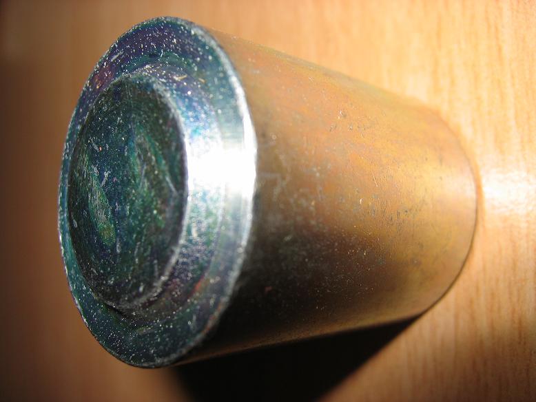

Tokico HTS spacer?
06-10-2007, 11:20 PM
Tokico HTS spacer?
original spacers
[Image: AEU86 AE86 - Tokico HTS spacer?]
06-11-2007, 08:03 AM
Tokico HTS spacer?
Thumbs up! sweet thank you DJexor

06-11-2007, 09:01 AM
Tokico HTS spacer?
Come to think of it.. I should have my spacers lying around somewhere still since Jamiemirror custom made some 2cm ones for meSmile
06-11-2007, 02:10 PM
Tokico HTS spacer?
SYM Wrote:Thumbs up! sweet thank you DJexor
no probs mate
06-11-2007, 07:55 PM
Tokico HTS spacer?
I got them from Max, as most of the others i think.
06-11-2007, 10:09 PM
Tokico HTS spacer?
Yeah got them through Max as well, I guess its Tokico thats a bit strange with it.
Anyways, I just checked, I still have the two 4cm spacers in my shed so if you want them... Smile
06-12-2007, 01:11 PM
Tokico HTS spacer?
Yes that would be great!
I also need a prothane bushings set. PM!

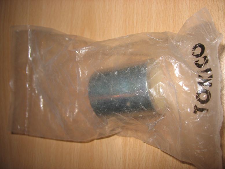

07-07-2009, 09:51 AM
Tokico HTS spacer?
I just installed my HTS112 F&R set to my hachi.
I used a pair of spacers, custom made, but identical to the originals.
The result is that my car is lower in rear, and higher in front.
I use APEX springs.
What am I doing wrong?
P.S. "Cut" is a not acceptable word to your answers Cool
http://www.ae86.gr
07-07-2009, 11:12 AM
Tokico HTS spacer?
I am just curious how you have forced those Apex springs to work on short stroke shocks(there have to be huge preload). Cut?
If not you probably need lower spacer underneath the front shocks and biger spacer above.
Can you measure the distance between wheel centres and fender lips? Just curious how low it sits.
p.s. I have still 2sets of high quality fensport springs laying around that i cannot use with my long stroke bilsteins.
Are you interested? Smile 4kg/mm front, 3kg/mm rear
http://www.86ers.org
07-07-2009, 11:32 AM
Tokico HTS spacer?
SekiguchiUeno Wrote:I am just curious how you have forced those Apex springs to work on short stroke shocks(there have to be huge preload). Cut?
They are not short stroke! 112 are longstroke.
The Fensports work better with HTS?
I' ll measure and I'll post pics asap.
http://www.ae86.gr
