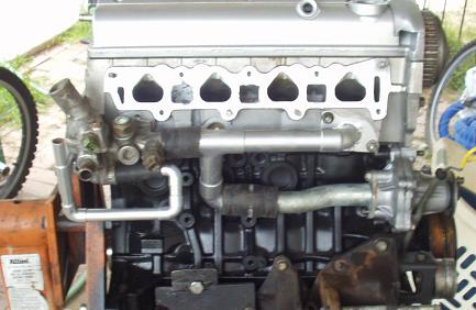

Source: http://www.geocities.com/MotorCity/Lane/...valve.html
Only I don't have the 4agze thermostat.
And what I have learned is that you want to have the engine around 85 degrees (celcius). Not any colder or warmer.

Warmer is possible...as long as the system pressure is high enough..
I believe porsche once started making engines to work at higher temperatures because it had certain benefits..BTW, that GZE thermostat housing looks the same as the AE92 GTi housing...need I say more?
