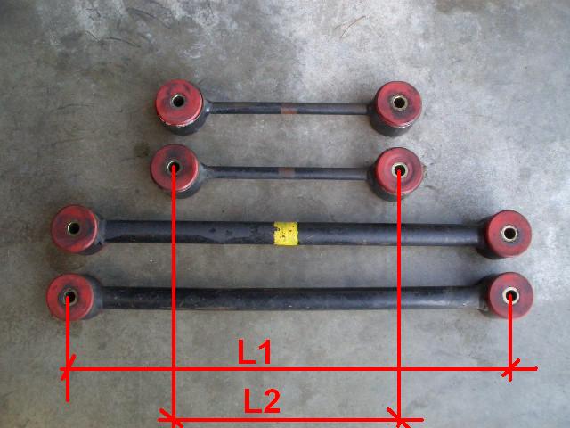

Hi guys,
Adjustment on my 4-links is way off, want to start from scratch using stock values as a baseline. Does anyone have some stock 4 link - bars that they could do a measurement on? Preferably from center to center.
Would be much appreciated.
[Image: AEU86 AE86 - Stock 4-link lengths?]
10-29-2009, 09:10 PM
L1 = 473mm
L2 = 244mm
stock lateral bar mounting points distance = 800mm

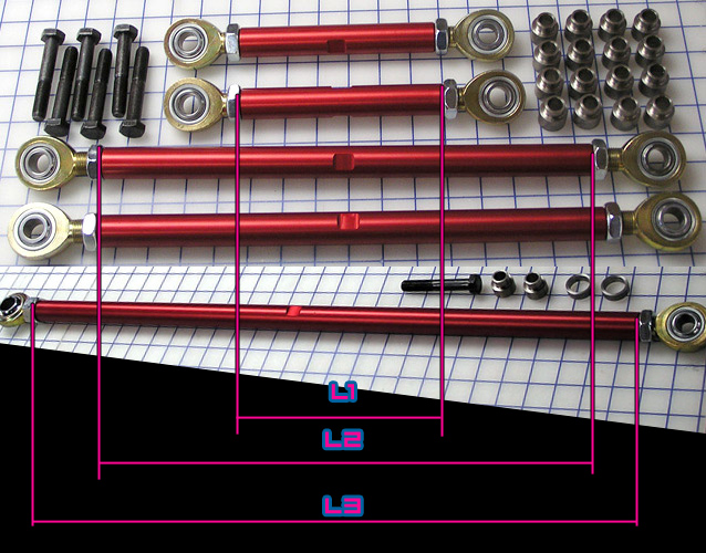

Gentlemen! i need your help!
would be somebody so kind to measure a set of adjustable 4links and panhard rod. preferably t3 or BV. i need the rods lenght by themselfs, without the joints and lock nuts.

NoHachi Wrote:I have a battle version set on mine. Will measure them for you when i go to set up the car (its parked in a garage outside of my city). Hopefully next weekend.
thanks! please do! counting on you.
