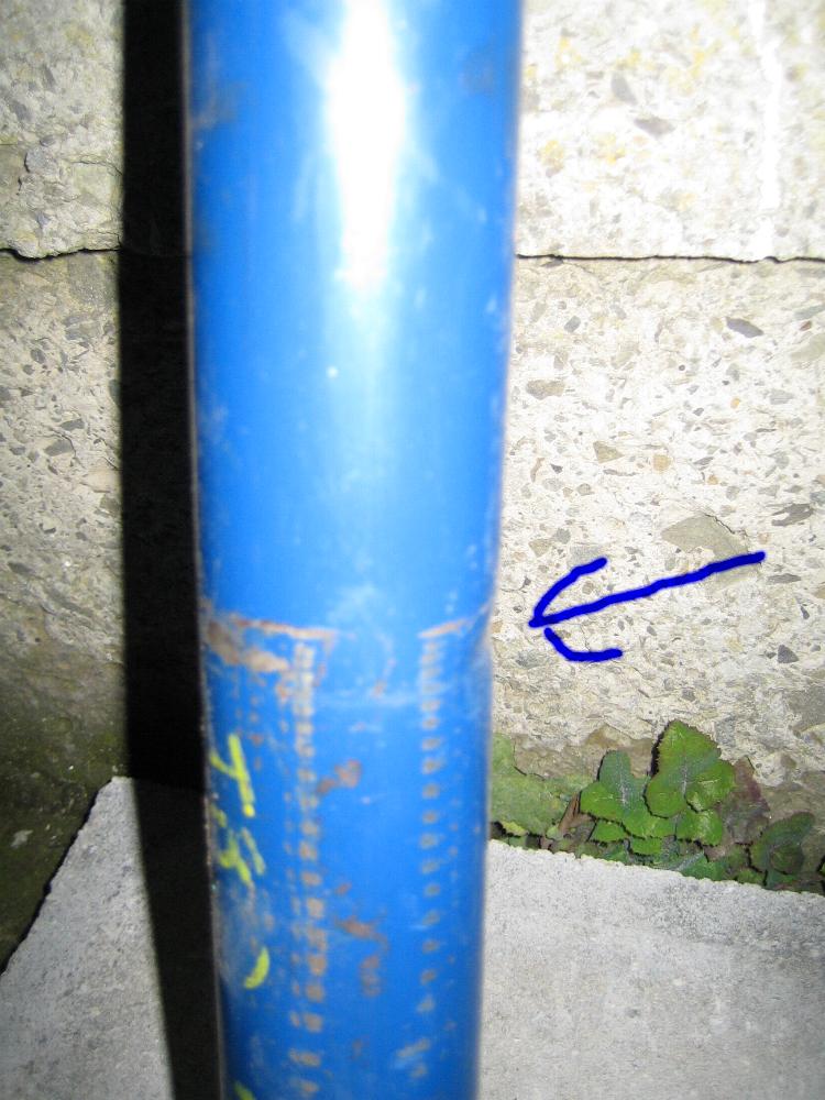

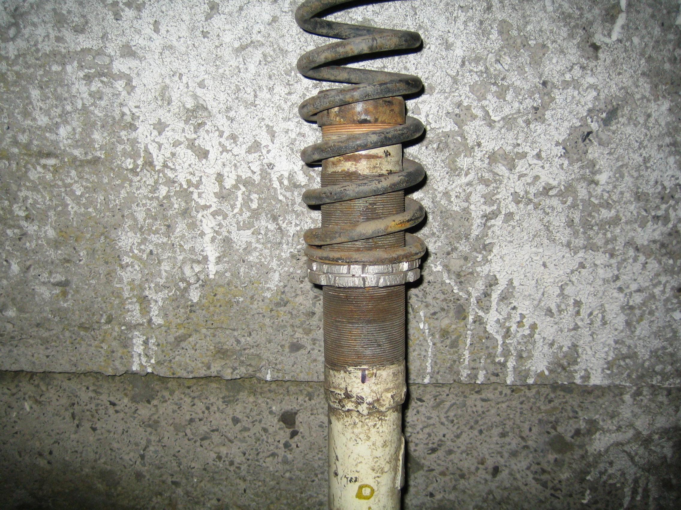

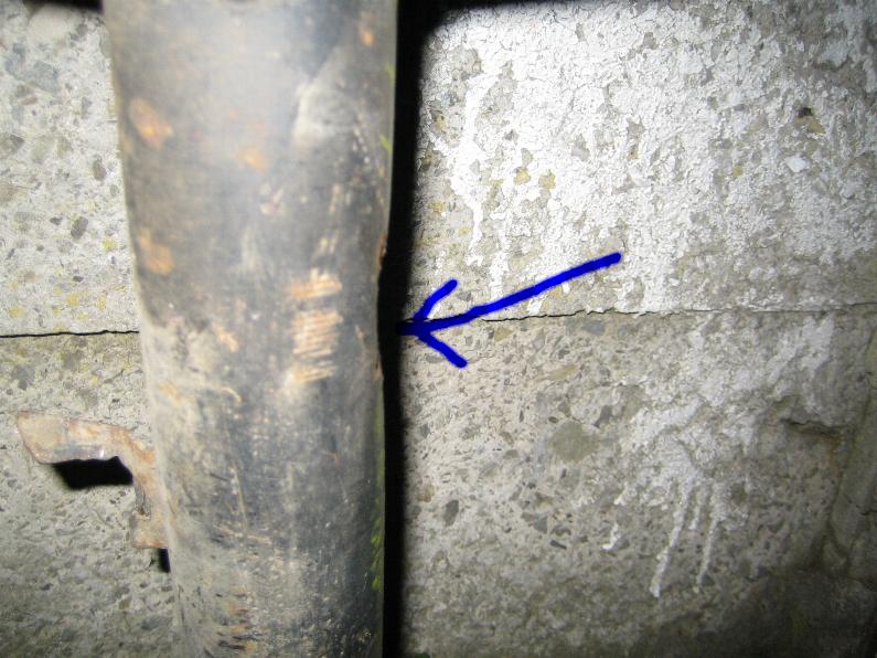

Looking at the pictures I would say the car is on the bumpstops this would give the illusion of being very stiff and causing the bending/breaking of components when driven on the loose. If you don't have progressive springs you are getting loads of travel on very stiff linear springs. Are the springs dislocating from their seats on full droop ?

To answer all : I'll try to do pics of the parts . But I can say that the main strut shell is bent ,the axle is bent and the shell shock too !
I confirm that it is stock strut , and the lower spring support is not in the middle of the strut . And that support is not bent .

here are the pics of the "damaged" parts .

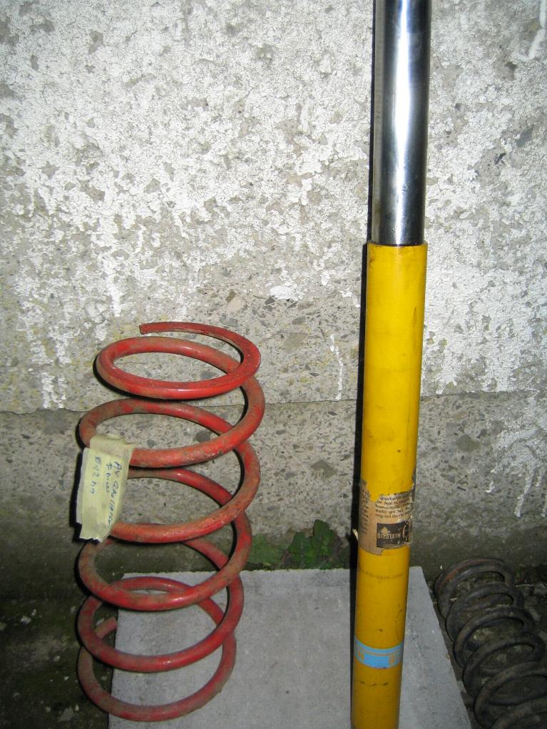

Non progressive spring .6kg?

Can you tell me the model number of the Bilstein damper, I am just in the process of getting some reconditioned and re-valved to suit 300lb springs. I'm not convinced all Bilstein sports are the same settings / model number. It costs £65 per side to re-valve etc. here in the U.K.

Looking at the photo's I reckon something has gone 'solid' at some point. I have had inserts go totally solid when hot and then go back to normal when cooled off, the easiest way to check this is to put some much softer springs on with the suspect dampers, drive the car over some bumpy road and then 'bounce' the car by hand at each corner while still hot. Mine were slightly odd in that they would stay 'solid' for days on end, only freeing off when the car was jacked up.

here is the number on the Bilstein shock : F4-P30 0098-H006
I 'm not really interested in rebuilding , as I had bad experiences with yellow and red Koni . I use the parts in races and there is no warranty .
So, when I got a pair of Koni rebuilded , they had leak at the end of my first race with them !!
