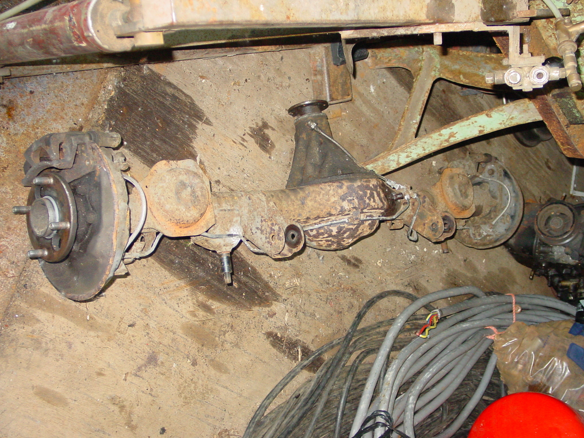

Also laying ready is a set of bushings. I will start working on the front struts this weekend and also my spare rear axle will be fixed up for the eye.
[Image: AEU86 AE86 - Robokill's Panda Levin Coupe!]
This axle has double layers instead of single.

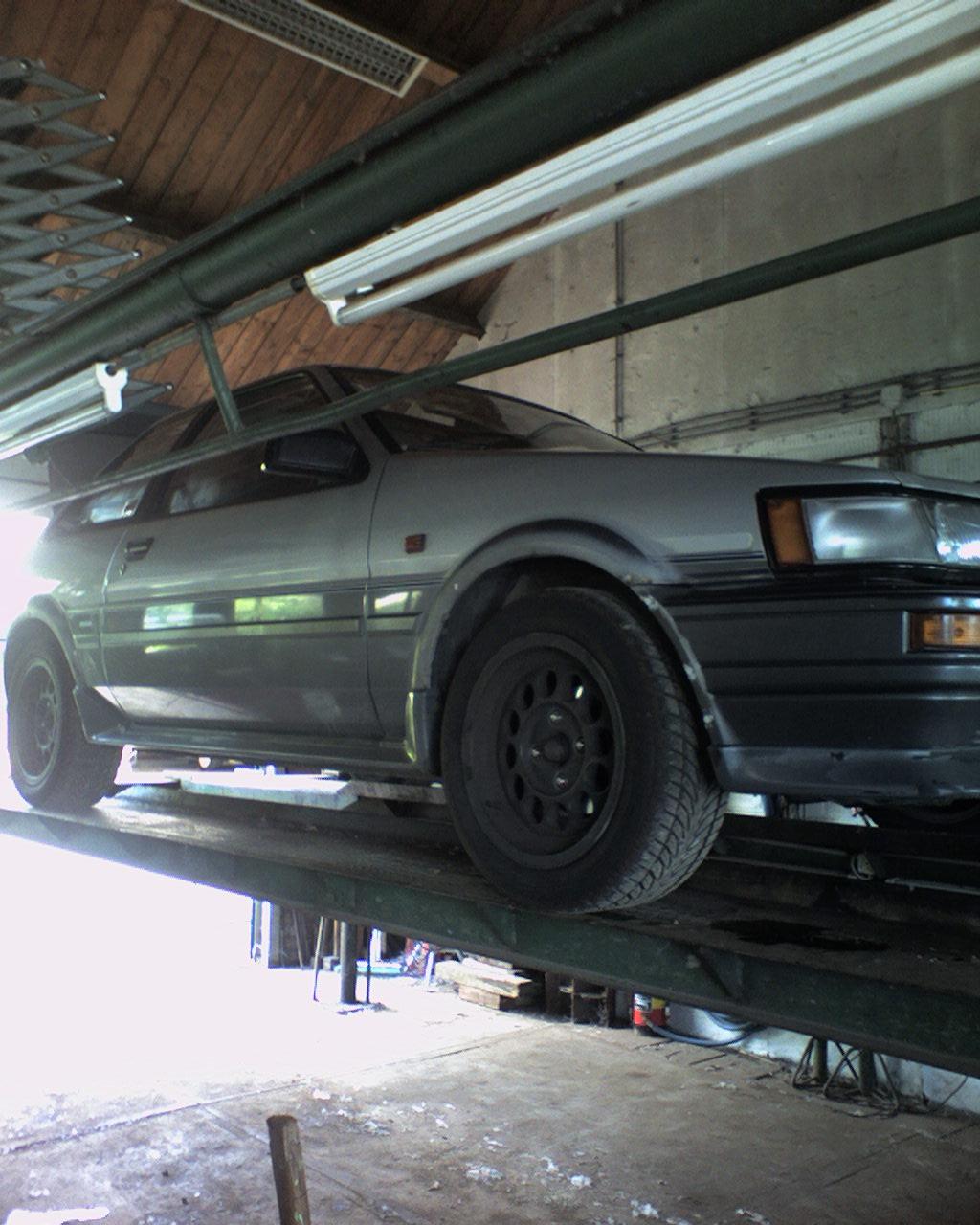

On the bridge ready for suspenion tuning.
Car is now low. So low that the rear wheel is falling in the rear arch. Looks cool and i can still take speedbumps. Altough i never thought the car would become this stiff
