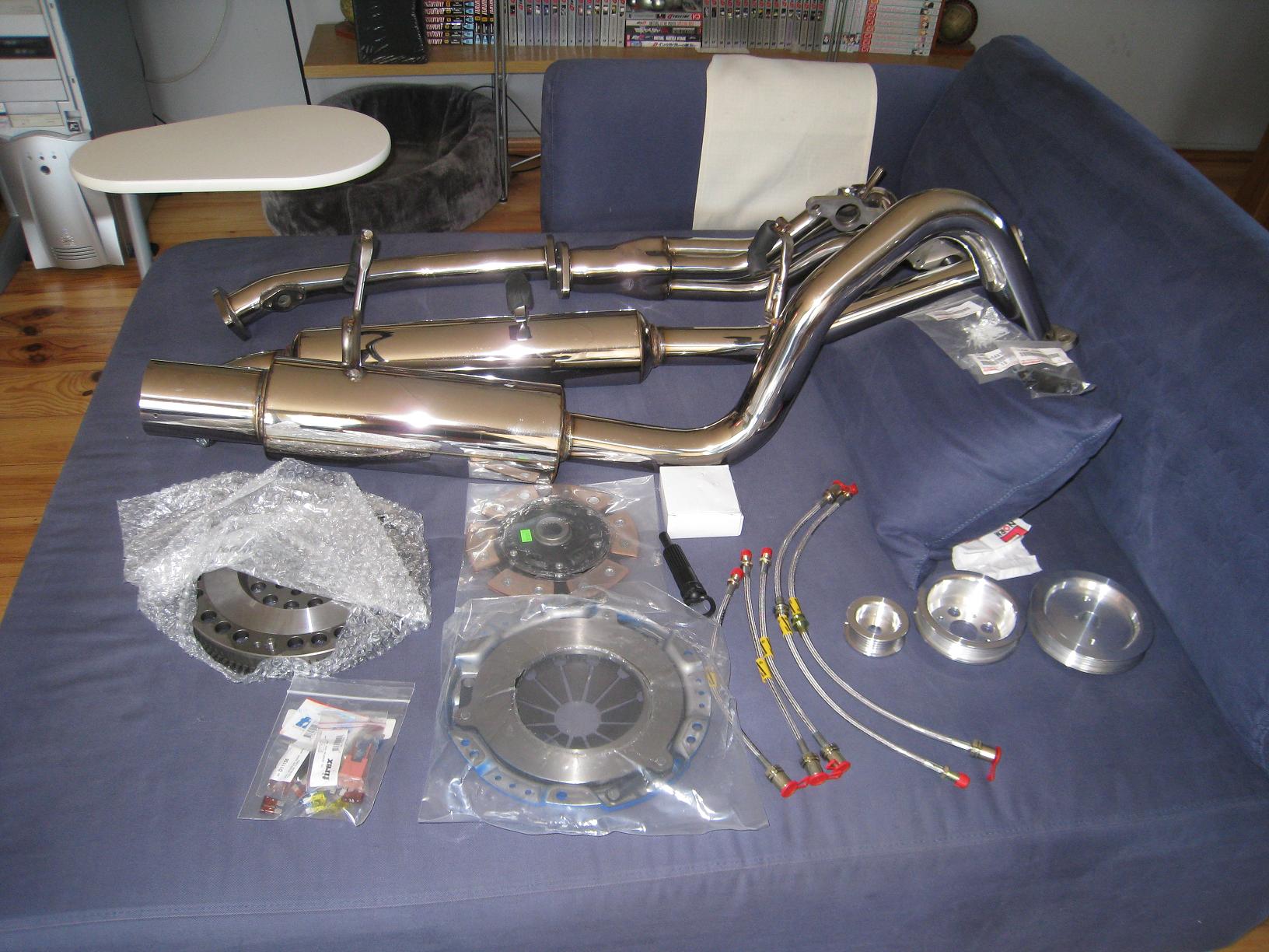

					New parts, all from ebay. (expect the toyota parts ....)
The OBX exhaust is really good quality if you ask me. (not yet mounted so that will be the last test) The piping has an inner diameter of 50mm which is as far as I know 0.5 larger than original. Which is perfect for a midly mod and a bit of increase. The flywheel comes from a power seller with over 10k of sales. And it looks really good. Same goes for the clutch. The pullies are from no other than aussiefan. I was amazed by the quality. Really good value. As I said to some friend before. I will use this car to test the quality and help of these products on this car. We will have to see what the future will bring Cars: "99 Lexus IS200 "86 AE86 Kouki Panda Levin GT-Apex (restore project) "84 AE86 Zenki Blue Levin (project racer) Motorcycles: "02 Yamaha R1 "02 Honda Hornet S "08 BMW R1200GS  |

					Shiney!
![]() And what your GF say about placing all that stuff on the couch? >
