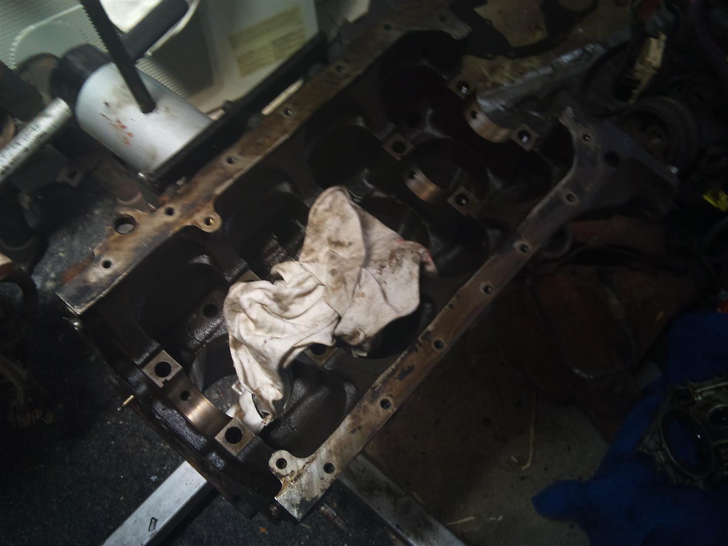

Well I ripped it apart completely and got scared while doing. I had a second look at the crank bearing caps..... They where mounted wrong.
As far as I know the bearing caps go from the front of the engine (where the pulley is to the back) in numeric order. So bearing cap 1-5.
This one had bearing cap 2 installed on the front and 1 on the second spot ?
So, I started with the oil canal on the second cylinder. I talked with many people about the 4age over the years and heard that the polish of the lower block is very good for the oil function in the engine.
Therefor I started grinding the walls and removed all the up and downs from the oil canal. I am nearly done with the second compartment. Then I will do the 3rd and as last the 1st and 4th.
So far I am thinking of doing a quick simple polish. Lower block will go to the engine wash shortly after being measured and hopefully honed. (instead of overbored)
