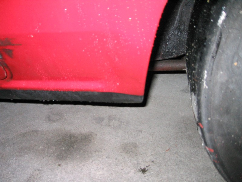

So now finally its back to the Hathi fun Wave
Update sofar is this: the ugly rust holes has now magically disapeared. Hurray!
