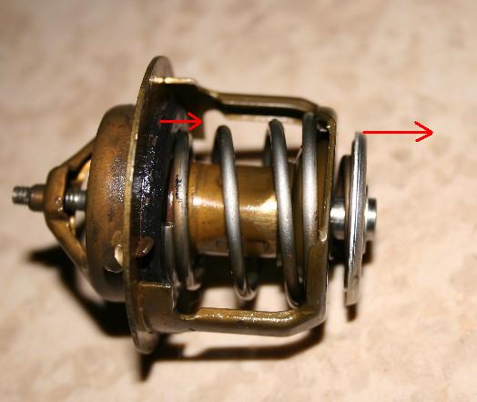

Then I dismanted the thermostat (thanks to ZaX for the info about it location Smile ) , and it seems it works ok. When I put it in cold water, both "caps" moved in the way shown on the picture...
I don't have any idea, what else could be wrong, because the heating is very poor, although there wasn't any air in the system... Sad Sad

I have also checked the working of the thermostat. I've found out that it starts opening at 72 degrees Celsius and completly closes at 69 degrees Celsius.
So I'm wondering what does the 82 degrees, written on thermostat mean. At the 82 start opening (small hole) or at 82 completly opened?
