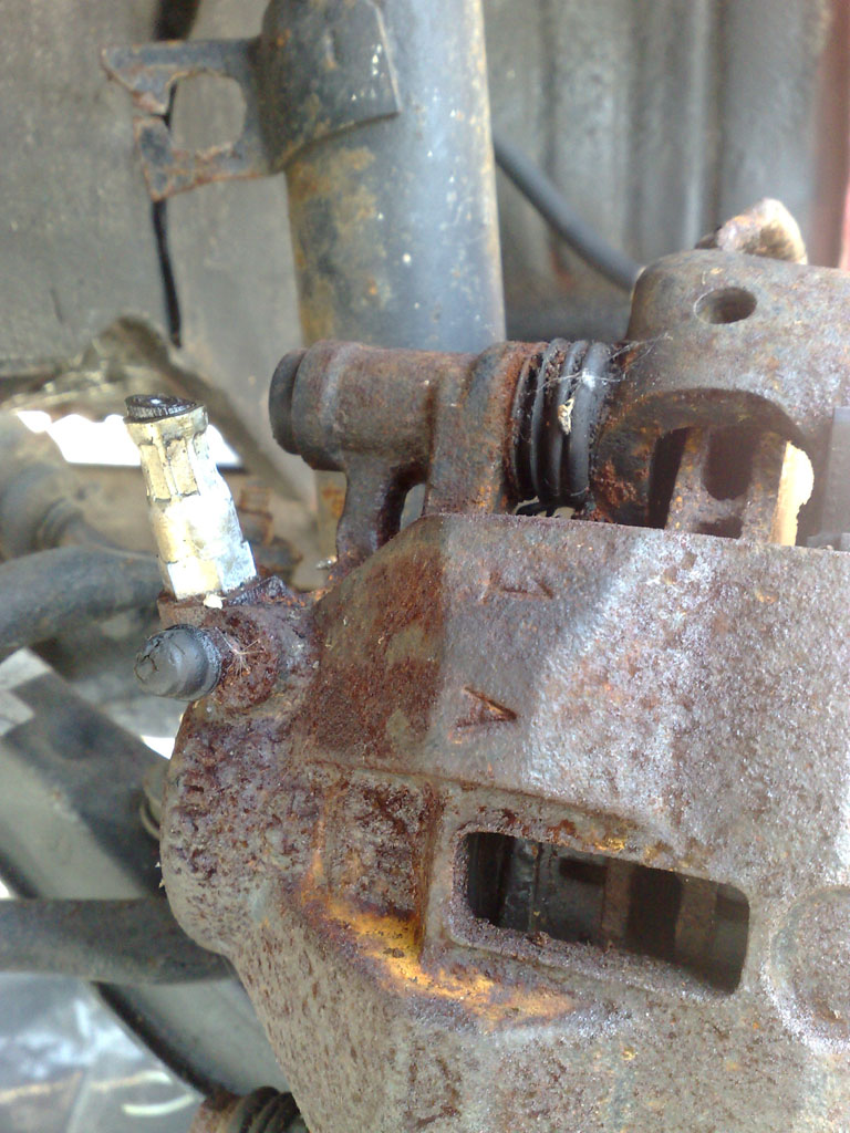

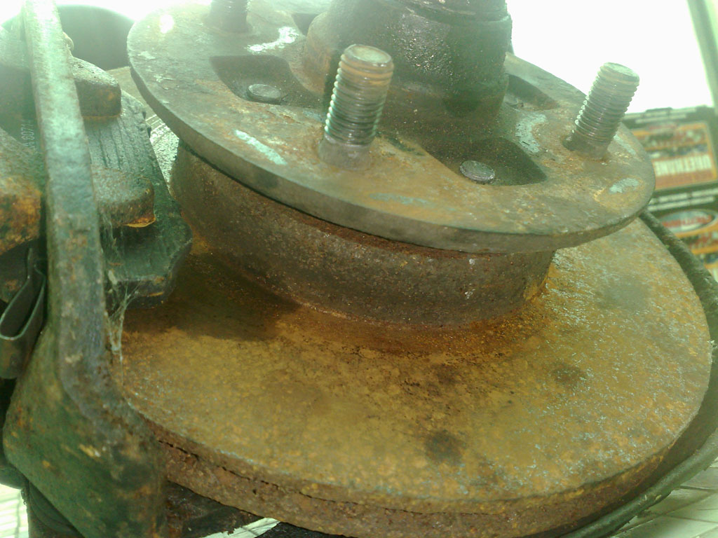

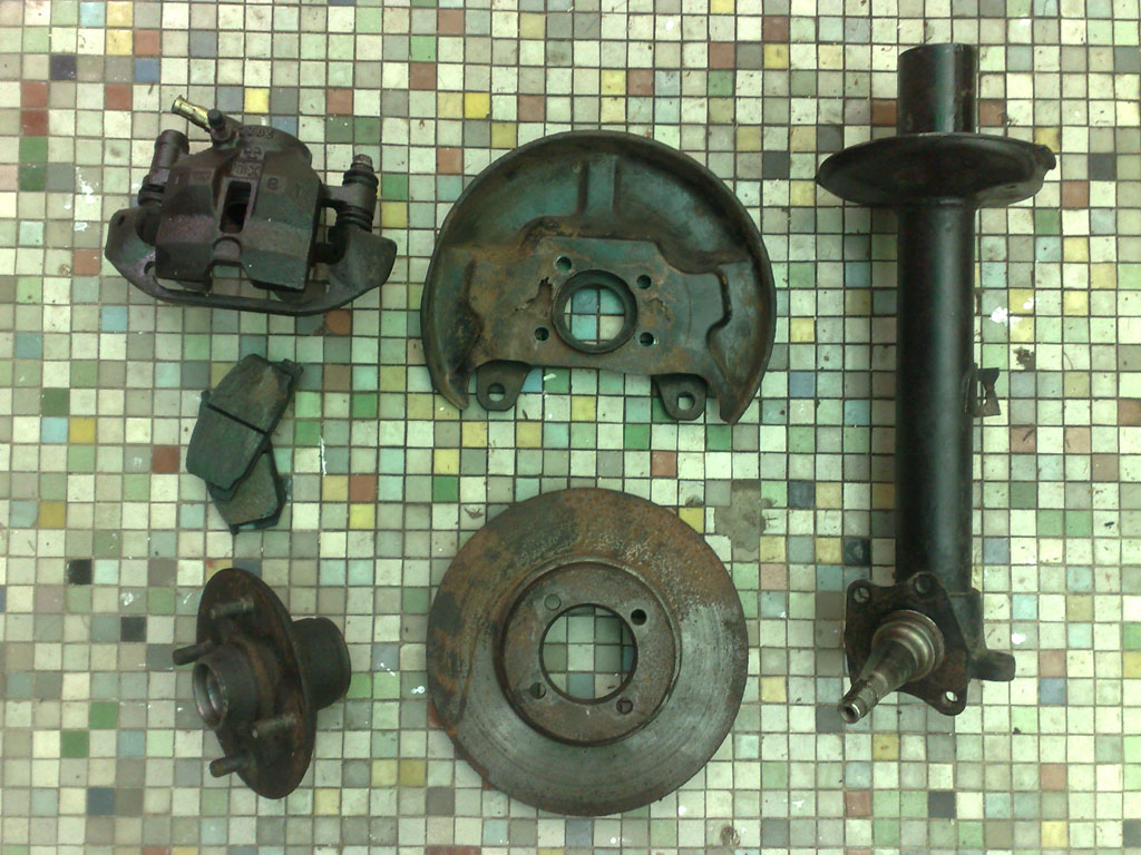

hello friends!
Finnally my car getting some of the love and attenntion she deserves Big Grin. Im redoing the suspension and braking system now. As you can see its in preety poor shape. I have new tokico HP's, apex springs, complete bushing set, proper wheels and tyres awaiting the installation. But first some rust problem solving. Here's where you come in.
I will replace the complete brake lines (the copper ones too) and the handbrake cables. Im thinking about overhauling and sandblasting&painting the calipers - i believe it will do the trick. Dont really know it they are siezed or not... But the discs just look too FUBAR. And that flange (hub-mud-shield) is rotten. What would you suggest me to do? It has to be a fairly cheap solution, but not to compromise safety. Performance is reequired to a degree, as this will be no racecar..
Thanx in advance and sory for the bad phone pics!
