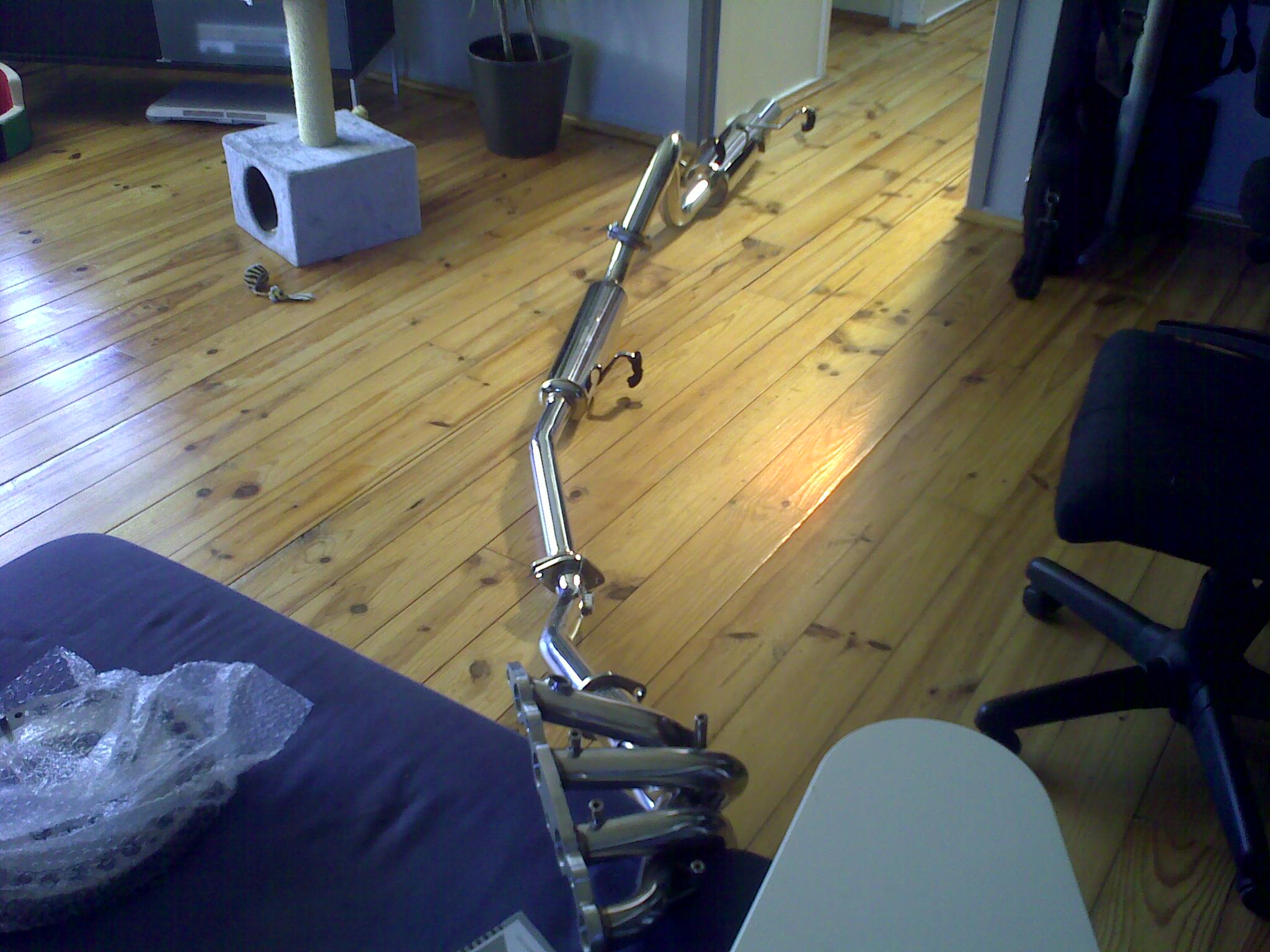

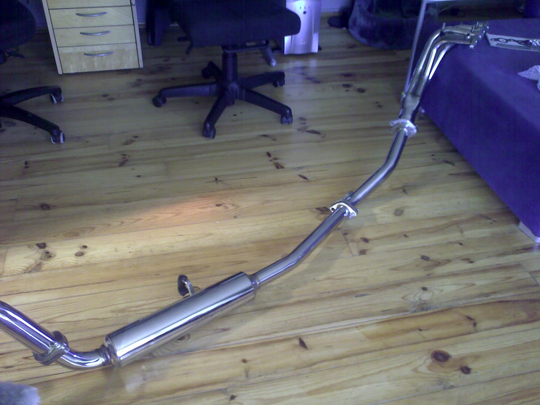

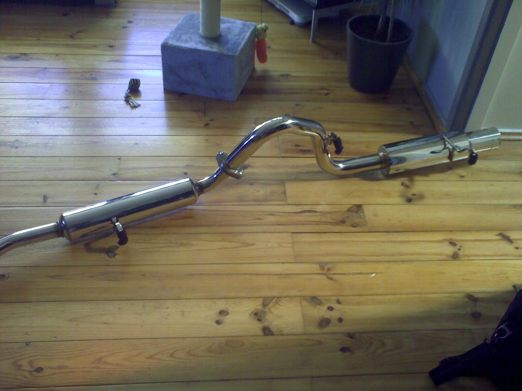

K here some pics. I kinda hung the system together to take a picture. Will be on the car soon. The welding looks pretty decent.
The systems seems to be around 1mm thickness and is very light.

I believe you will find out that there is a bit missing ( it was on mine )
the OBX headers comes with a pipe after the headers and then there should be the CAT. After the CAT the OBX "cat back" is used.
If your not using a CAT you will have about 30cm of exhaust pipe missing.
They don't fit in the car bolted on like you have them on the picture.... you need a decat pipe or just extending one part of the exhaust.
In the bit that is missing I installed an "exhaust flex". It helps preventing cracks on the exhaust by absorbing vibrations.
