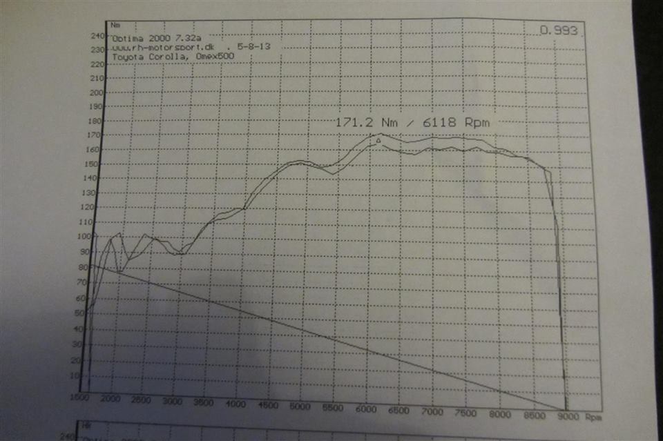

Yes sweet engine...but max torque @ 6100 is a little high so the plan is to convert to 1NZ valve lifters and get a less aggressive cam with +10,5mm lift. Engine has now run ~1000km so time for an upgrade Big Grin

do you have a dyno graph - even if we don't know the exact spec of your cams. Hopefully during this summer I'll have my engine together and tuned too. Still considering to go with different cams but have to see where I am right now.
On another note peak torque is not necessarily bad at 6k if you get a good percentage of it already lower down. For driveability the area below the torque curve is more crucial than final numbers.

Torque and power..
