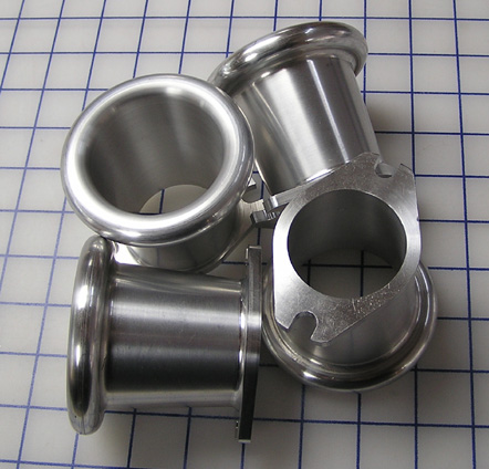

Check T3, they have them. Here is a picture. Would be great if you can make it to the Silverstone day. Places are ltd to 35 so they might be full soon.
I know what you mean about getting all the practice you can get, drove 200km one way yesterday morning to get some track time in France. Was worth every KM tough Big Grin Big Grin Was able to hold some nice drifts in the end Big Grin Big Grin
The trumpet situation on your car does not sound good, where was it done? In Japan? Huh Huh

I can get the 4xITB trumpets/velocity tacks for £102 delivered to my door !!! I think I will be having a set of these once I can confirm I can get correct fitting socks from Pipercross/K&N.

Glad you got through with the velocity stacks! They look very nice. Make sure you tell him which 20V ITB you have, blactop or silver top as they are different!
