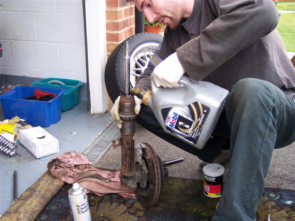

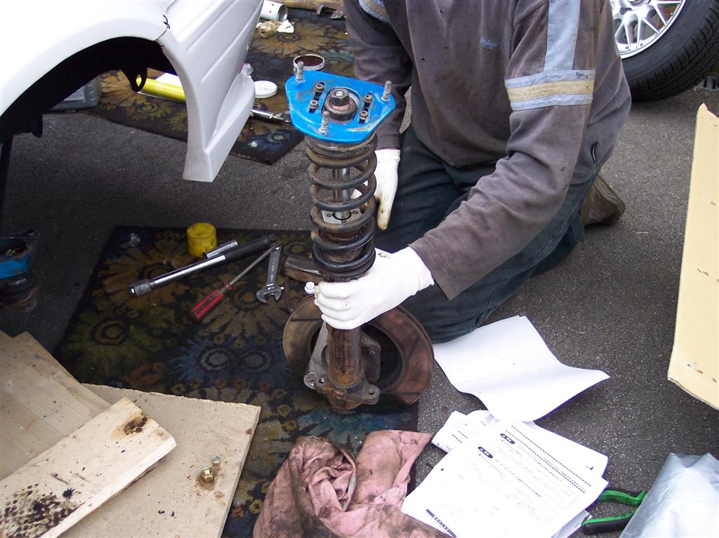

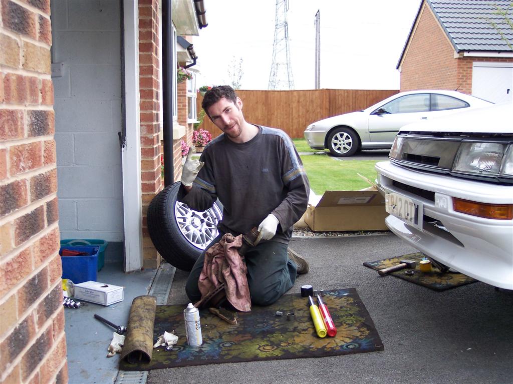

big big thankyou to my brother for helping carry out the following work on my car this weekend.
Fit TRD solid engine mounts (A pain in the ass job)
Fit TRD solid gearbox mount (A slightly less paint in the ass job)

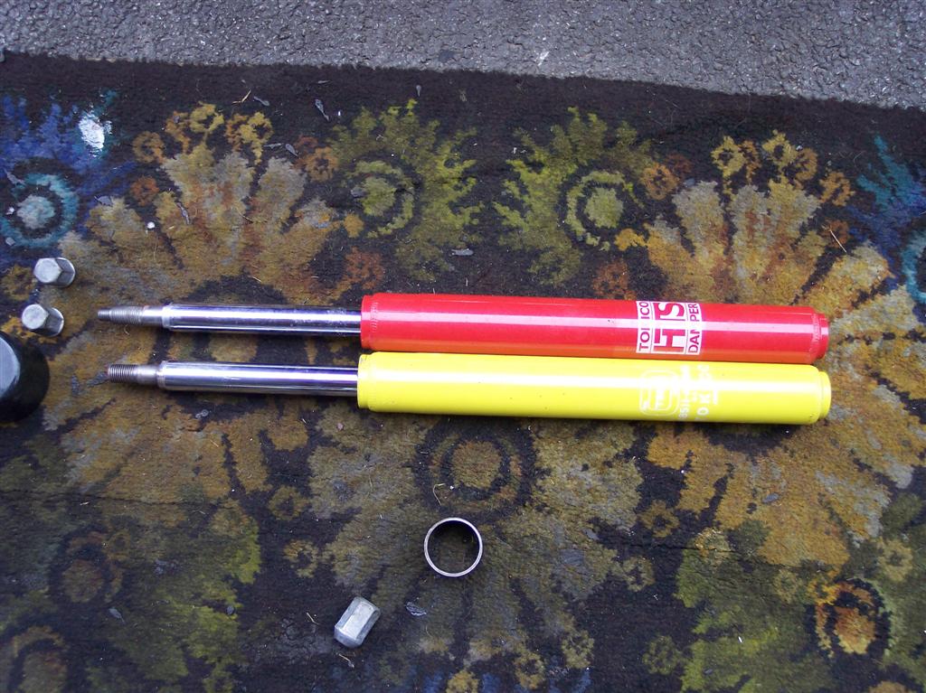

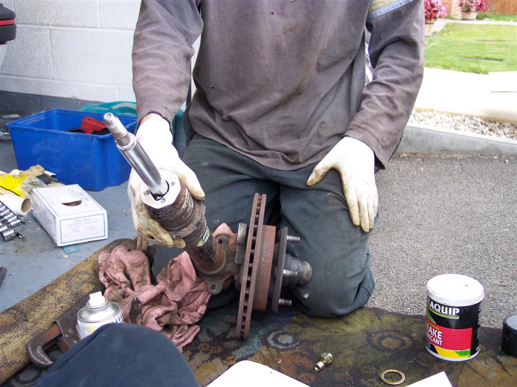

Strip from suspension struts - remove old TRD damper inserts, clean up the bodies and replace with brand new Tokico HTS adjustable inserts.
Interestingly the yellow TRD inserts that I removed had exactly the same body lengths as the HTS we put in so no new spacers needed to be fabricated. Also - it was interesting to find there is NOTHING wrong with the old yellow inserts - it was just one of the spacers was slightly short making the cartridge move about in the body. Packing the new Tokicos out with a washer has stopped this movement.
Clean and grease the spherical bearings in the Cusco front camber plates - they were not very well greased at all - now they are much smoother.
Remove TRD rear dampers and replace with Tokico HTS 45-way adjustables. Interestingly I'd figured we'd need to jack the car to do this - but my brother simply left the car on the ground and removed them LOL. It took a total of 10 mins. The springs themselves supported the car just fine.

"The Tokico instructions say fill up with the strut casing with a light oil to act as a heat transfer fluid. I know folks who run HTS without but we had a bit of the good stuff in the garage so it will do the trick LOL"
Koni advise to use anti-freeze coolant. I would never know why till you wrote this Thumbs up!
