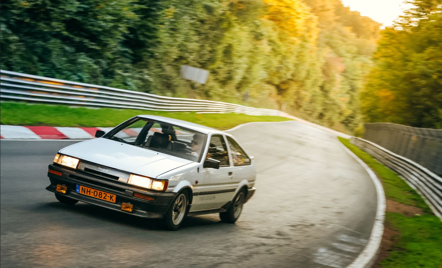

- Nurburgring Nordschleife with the 86 (have been there a few times in the past already)
[Image: AEU86 AE86 - NL: Robert]
