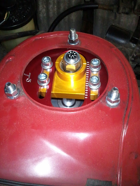

17.09.2012 Started taking the old suspension out... hammer_1
22.09.2012 New Suspension finnished Big Grin
