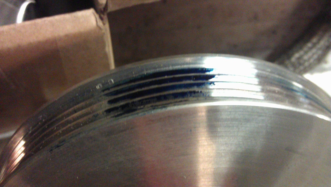

Made a crackshaft pulley on a lathe and spark-eroded a keyway in the pulley.
Made a contact pattern and everything fits well.Next up is the trigger wheel, i drew one but can't really find the specified sizes for the teeth online so i divided the wheel op 50/50. 50% is teeth, 50% is empty.also made a hole on the other side of the missing tooth, keeping mm2 and distance from center in mind (the missing hole surface is bigger than the missing tooth surface)
ofcourse any suggestions for corrections are welcome!
