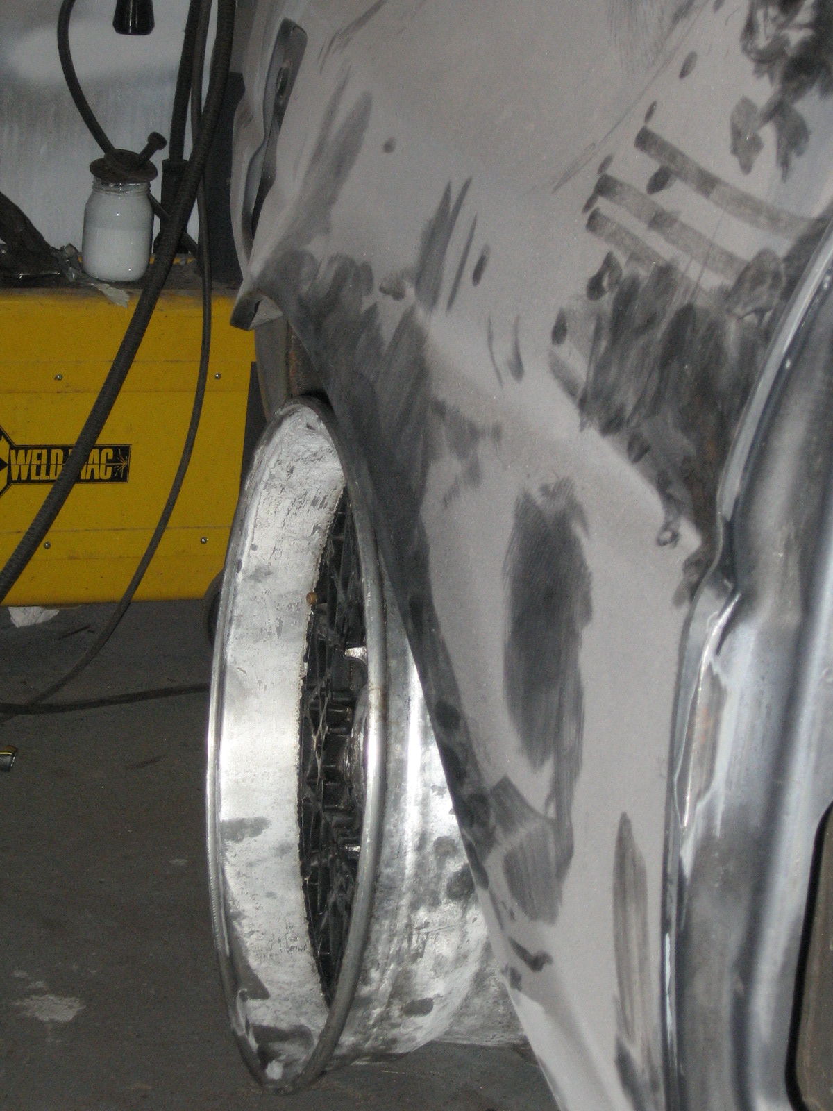

Did get some work whit car.

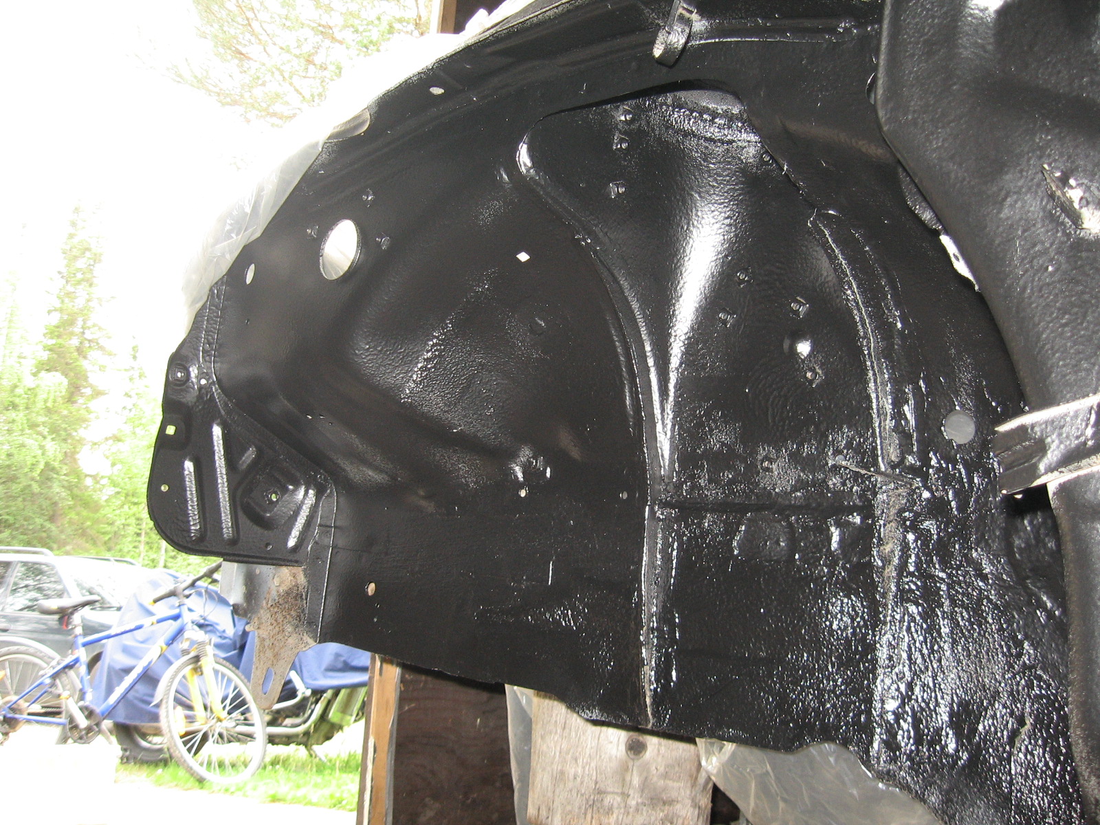

enginebay in paint, Just need wet sand and onelayer paint more to be ok.
Some holes i did weld off.. rear suspension "rustwork" i deside to work also. Just origin stuff off and make all new.. 3-4cm bigger radius on shocks on rear..

Long time gone, test fit the hiace rear end to car, and +4 et 7x15" wheels nice fit. still could be little more wider.. custom driveshaf from friend and 4.3 whit lsd to rear end...
did think about brakes, mk3 supras rear breaks or just s13 nissans bigger disk and regular ae86 calibers or similar set..

will you keep the wide body look or?
Do you like the trueno front ?
07-13-2012, 09:41 PM
Mine AE86 from up norht
i am keeping the widebody, but put cby Flares and levin front end

Had some work done to car. genuine trunk "door" had some un wanted holes on it. Weld them up then some tin and looks ok. "cby" flares needs some work to get them fit nice and only rust work left is in rear suspeonsion towers and few minor work. Then i get to last underbody welds grind and some sandblasting to them and paint stuff..
The LHD side door hinges are quite bad condition need find better/new..
