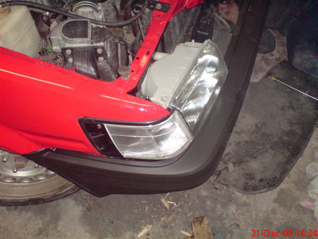

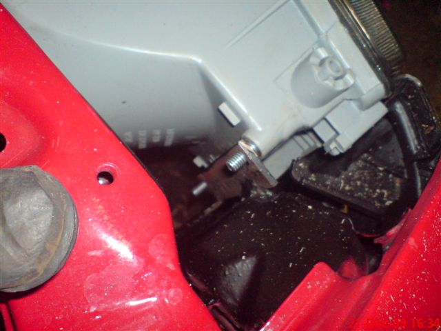

As I promised, I'm sending some pics with uno headlight conversion. We welded the brackets yesterday night. 2-3 hours job. I hope I will manage to fit the bumper and the hood today afternoon, so I will post more pics when done.

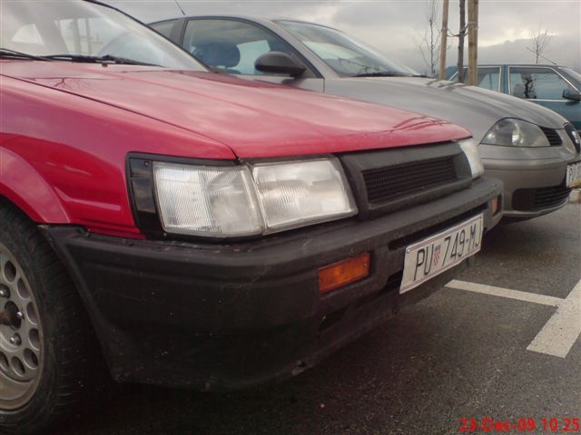

Uno lights + Tipo mask we found in the backyard Smile
There is a little problem with headlight lens adjuster; I still need to fix it. The adjusting screw is to high so I had to remove it in order to close the hood properly. Now the beam is to high. I need to think something out.
