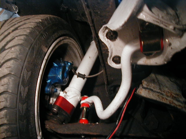

2-day i fitted the entire front end bushings - except for that very same as Widar is having trouble with.

i did not think so...
It was really easy to me.
If had not sanded & painted all the things - i would´ve changed the bushing in about 30 min
Even the control-arm bushings are SUPER EASY to FIT -
all you have to do is loosen the 4 bolts that hold the steering linkage to the floorboard... raise the linkage a little.. & remove the bolts from the controlarms. - swith the bushing - & wice versa.

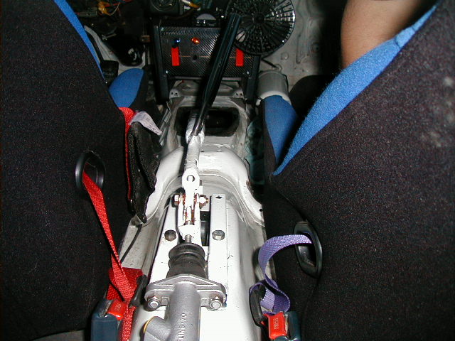

hydraulic handbrake assembly all done today !

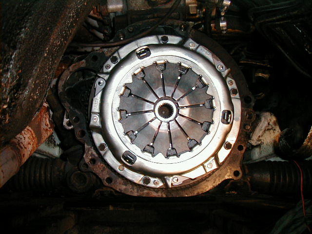

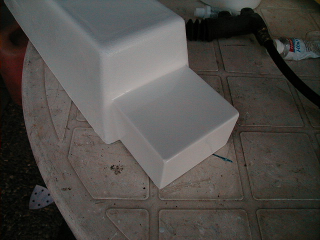

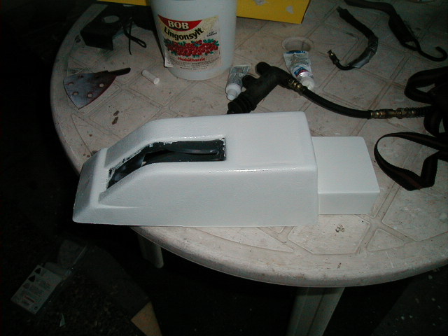

today i fitted the TRD preassureplate & the new raceclutchdisc & some more stuff was done for the car.
for example - look at the e-brakecover...
i redesigned it to also cover the hydraulic handbrakecylinder.
