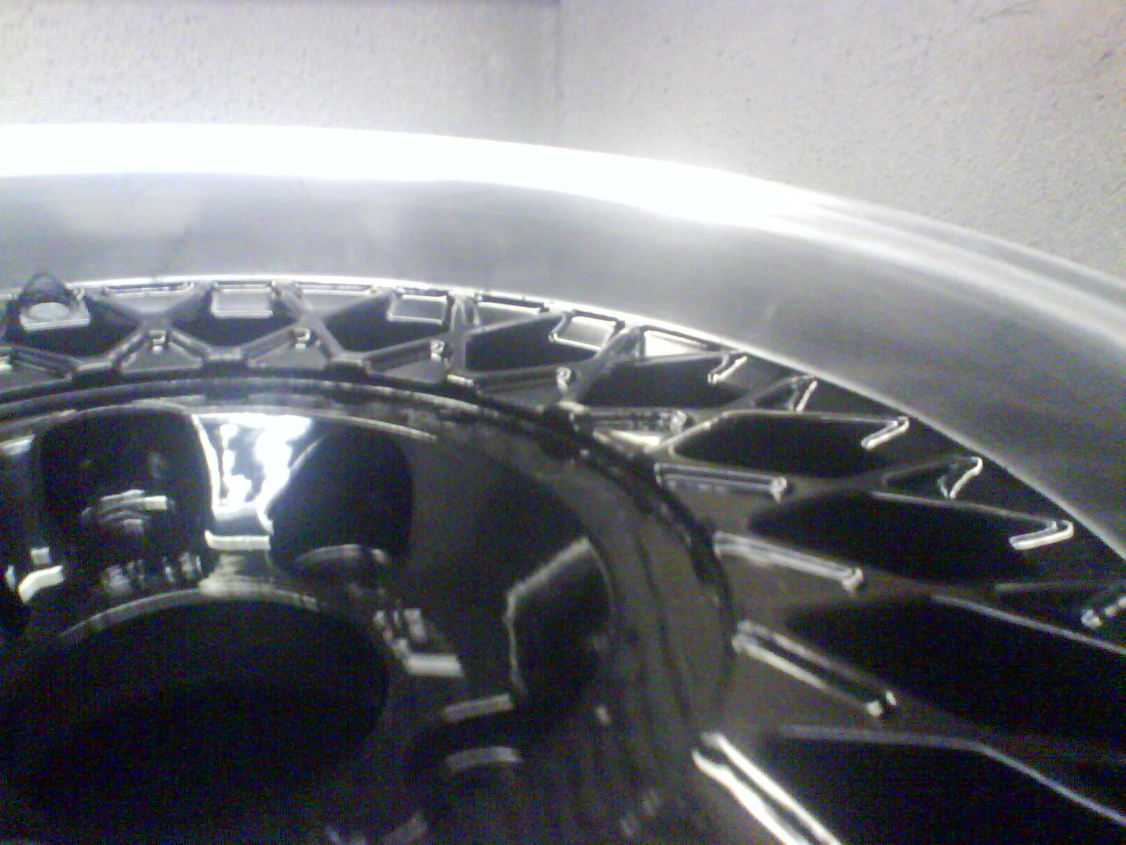

Sorry for the poor quality.. my phone usually takes good pictures, i must have messed something up.

How did you polish the rims? Nice rims:-)

I put it in a lathe (drejebænk) and used alot of sandpaper. Then autosol and alot of regular polishpaper. Tomorrow when the black paint is dry, im giving the rim clearcoat. Youtube Myspace and I´ll Google your Yahoo |

Ok cool. Witch kind of sandpaper did you use? Like "korn" 1000 or something?

First i used a 3M "paintremover thingy" on a accudrilling machine (?) to remove all the paint. Then grid 100 - 240 - 400 and final grid1000. And to polish it autosol and paper.
The result isnt shiny as a mirror, but then, it wasnt intended to be. Youtube Myspace and I´ll Google your Yahoo |
