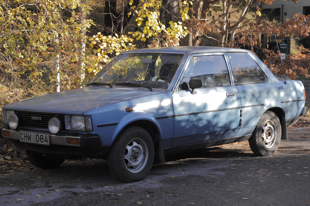

[Image: AEU86 AE86 - KE70 Tuning Advice!]
11-18-2010, 02:07 PM
KE70 Tuning Advice!
Pic of the car ^_^
