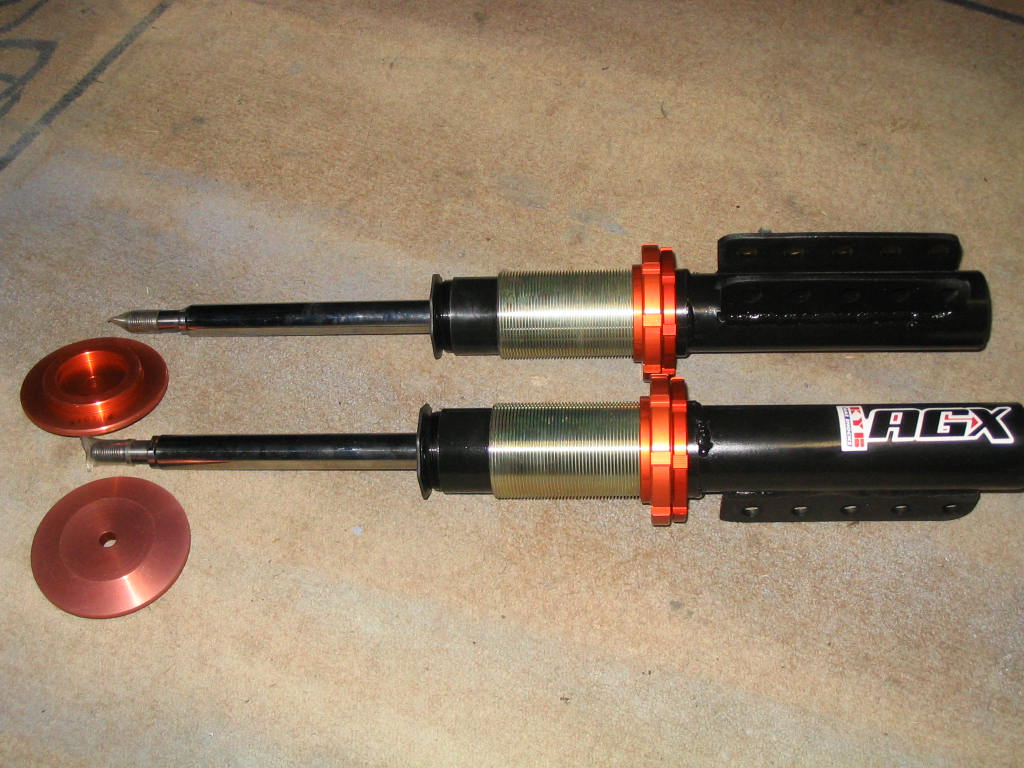

me and a good mate of mine (mostly him) have been designing up s13 coilvovers that will work in an 86... here is a pic..
http://img145.imageshack.us/my.php?image...sio1zn.jpg
these have mutable height adjustment to run either 14,15 or 16 inch rims... and have been strengthened at the the bottom to handle the extra force of running 390 to 500ib springs...
Mine have specifically been designed, to run with 16inch wheels that are between 8 - 9 inchs wide running around 30-40+ offset and have been shorterned so the car will be around 65-70mm lower then standard, HINT HINT on what is to come, let see who guess hahhaa
ill be running a KYB AGX shock, 392ib spring, Cusco ae86 camber tops, going to make up custom top hats like t3s but actually work and will be using my thrust bearing spacer..... should be a very capable steerer in my opinion

I took the liberty to attach the pic to the post. Wink
But he designed them himself? Dumb question
[Image: AEU86 AE86 - JDM Coupe]

banpei Wrote:I took the liberty to attach the pic to the post. Wink
It seems that he use different strut construction (2-piece) or S13 front hubs conversion.

Yeah these are Jap Spec s13 legs, im going to be using an s13 hub with r32 gts-t brakes...
By design (mostly my friend) i mean, test multi able cut down of the strut, in different car with different variables, with different strut offsets to the hub and alot of things.... but the coilover is easy part of the s13 to ae86 coilvoer conversion. the other problems are getting th angle of the castor rods right, and what castor rod to use, strengthening the mounts to the cross member and so on and so... that will be coming soon Tongue
The legs have been cut down to allow perfect shock travel and to match the spring that i will be using... then a KONI coilvoer kit was welded on. Then they where painted and we added the AGX sticker to show what shock i used Tongue
cheers
