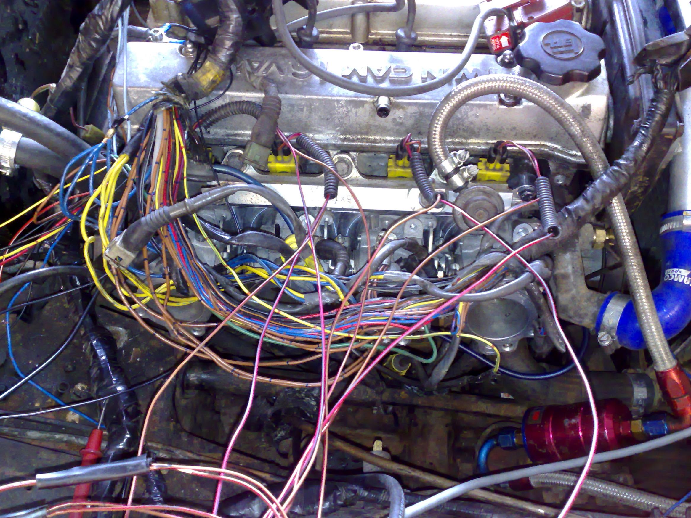

I took the toyota loom apart. The injectors seem to be wired so they fire all at the same time. The injector has two wires, yellow and blue. The yellow wire has 12dc when the ignition is on, the blue wires all join together in the loom and then go to No:10/20 on the ecu. This then switches them to ground. I have attached a picture, you can sort of see it at the left hand side of the photo. I will take a close up picture tomorow. I'm going to take the toyota loom off the car and start from scratch.
