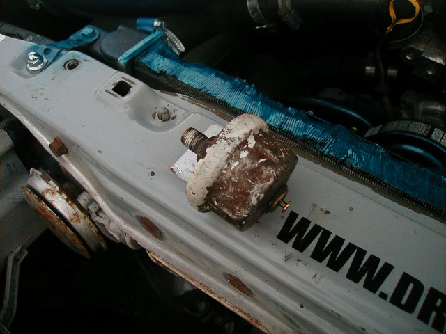

Step 4:
remove oilsensor from engineblock - located in front of oilfilter. it may be very hard to loosen. I´m sorry sir, your planet has been sceduled for destruction in favor of an intergalactic highway -Thank you Kristian Hesselmark, Sweden EVO-DRIFT-STREET-DRAG-SHOW |

Step 6:
Purchase suitable oilpreassure sender from an Honda Civic - will fit from -Civic/CRX 84 -91 I´m sorry sir, your planet has been sceduled for destruction in favor of an intergalactic highway -Thank you Kristian Hesselmark, Sweden EVO-DRIFT-STREET-DRAG-SHOW |

Step 7:
fit these object together - not forgetting the very important threadtape. I´m sorry sir, your planet has been sceduled for destruction in favor of an intergalactic highway -Thank you Kristian Hesselmark, Sweden EVO-DRIFT-STREET-DRAG-SHOW |

Step 8:
Reattach onto engineblock & fit the correct wire to the correct sender. DONE. Kris I´m sorry sir, your planet has been sceduled for destruction in favor of an intergalactic highway -Thank you Kristian Hesselmark, Sweden EVO-DRIFT-STREET-DRAG-SHOW |

I hope im not being an ass, but thats the wrong way to wrap the treadtape... When you screw the fitting into the block, the tape will actually come off and then the joint isnt liquidproof. Its ment to go the other way around :wink:
