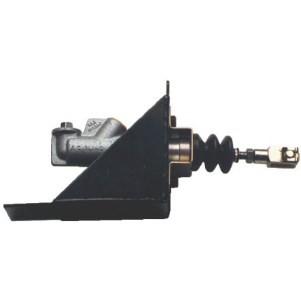

here is the vrite-up.
buy this item from british http://WWW.RALLYDESIGN.CO.UK
Hydraulic Handbrake Conversion Kit
[RD3624] £37.50
http://www.rallydesign.co.uk/catalog/pro...ts_id=4092
Then find the rear going brakeline.
Just before it attaches to the rear axle there is a coupling.(split)
screw this apart & attach an 100cm new brakeline to each of the splitted brakeslines.
The line that comes from the master brake cylinder will be attached to the rear of the handbrakecylinder - & the other brakeline will attached to the front of the cylinder.
for the handbrake cylinder, you must find a way of attaching it to the cars body / stock handbrake mounts.
Now all you have to do is to bleed the rear brakes & you will have an HYDRAULIC HANDBRAKE in your car.
please observe - do NOT pull handbrake & then press fotbrake without letting go of handbrake
kristian[/b]
