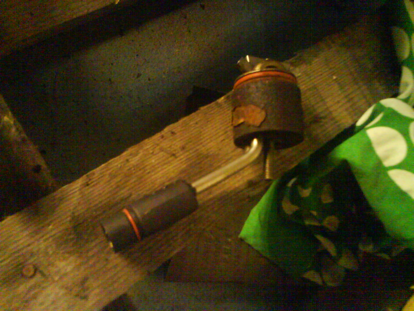

Help to find this on harness.
01-01-2008, 03:52 AM
Hey im doing all possible w my conversion and i cant find this one on the harness. help. think it is for the oil pressure dunno or heat.

01-01-2008, 06:39 AM
Is that 4AGE that you are talking about ? is so its just one wire terminal as is the sendor unit , its just a resistance or the engine earth though the unit. That terminal in the picture doesn't even toyota and about the only three wire Toyota ones are J series engines with the oil level and pressure built into one unit.
01-01-2008, 02:35 PM
That is block heater element, made by DEFA. It needs own harness.

01-01-2008, 02:46 PM
now when u are mentioning it. Your right.. haha newer thought of it. thanks. i hope you will be finished w your car soon Tongue
