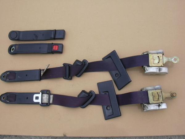

IMO you should replace the whole belt: they are in your car for a reason, so you might need to depend on them.

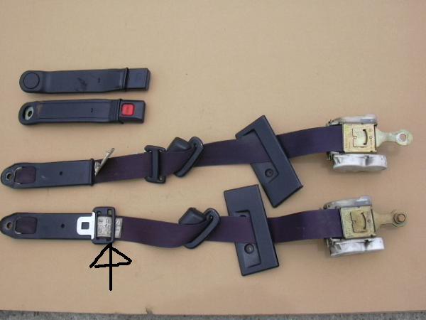

![]() But perhaps it's better if you illustrate which part is broken on the picture underneath: ![]() In this topic you can see what Mux is refering to with the roll-up mechanism locking up: http://www.aeu86.org/viewtopic/installin...elts/t/110 1983 - AE86 Sprinter Trueno - import project 2013 - Honda Civic sport - daily driver 2004 - AEU86 dot ORG - daily domain Support our forum, buy from the AEU86 shop:

hi, u can see where i pointed the arrow as that part is snap so the buckle is alwyas sly to the bottom of the belt if you know what i mean, bu is still functonal......thanks

Ok, think we talk about the same thing. It is possible to get them off, however then you would have to damage the "safety" tags on them and probably if you encounter a harsh MOT inspector your car will probably fail. But who to notice if the plastic surrounding is back in place.
![]() But I still think it is better to replace the whole unit. Not too much work, takes about 20 minutes to change.
